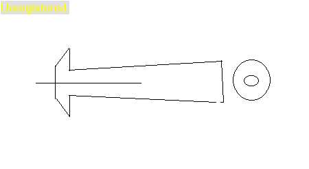

I made a tool for removing wheel bearings in just such a case. Requires a lathe... may not be for everyone but works a hot damn.
Excuse the extremely child-like pic I whipped up in Paint (no graphic artist skills here...).
I used mild steel. Overall length - min 50% longer than bear-bear distance. Diameter - largest diameter just small enough to slide inside bearing/spacer. Hole through center large enough for your favorite long tapered punch. Cut center line with hack saw/ band saw.
Slide tool in from the side opposite bearing being removed. Line pointy bit up where bearing and spacer meet. Push your tapered punch into center hole of tool from the side of bearing removal until pointy bit well seated between bear/spacer. Butt other end of tool against something solid. Whack punch a couple of times. You should now have room to punch out bearing normally. If not whack it a few more times.
If this made sense to anyone - you obviously are not drunk enough!
cheers,
Ryan
