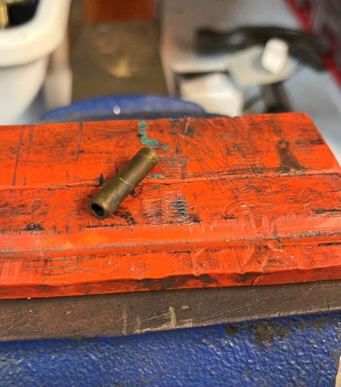

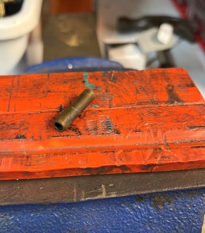

All back together with this bush used on the retention screw for the headlight lens. The screws that are either side of the headlight which are used to pivot the headlight when loose are around 10mm diameter so a lot larger bush but I don't think it uses bushes.
You know, now you say that it is so obvious! Mind blank! Now I just have to find the fastening clip that the screw tightens into that rattled under the work bench somewhere. It has an aluminum piece screwed into the headlight to hold the clip as the plastic piece fell apart. It doesn't hold the clip as well as it should. Thanks for the good guess Pete.
Greetings! I pulled the headlight out to change the bulb and had this pin/bush/spacer fall to the floor. It's about 25mm long and around 6mm diameter, Haven't measured just a guess to give an approximate size. Checked the parts fiche but don't have one for the Cafe sport headlight/fairing assembly. I couldn't see anything resembling this. Anyu ideas what this is for and its location? Thanks!
