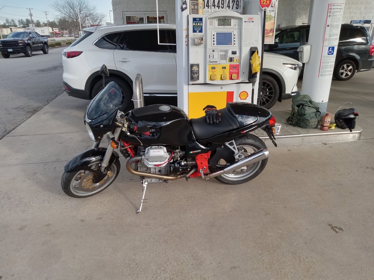

I'm only running Shell premium 93, but after an indicated 45-55 miles on my ODO...the fuel light comes on. Also, only getting 23mpg (1st tank) and 21mpg (2nd tank)...around 2-2.2 gallons to the filler neck, so the ODO might be a little "fast" on distance? This is a 5.8 gallon tank, I think? A bit early for the fuel light, perhaps. Granted, I let her warm up for 5-10 mins before each ride when she is cold...granted, she sits around 80mph in 6th (4500RPM) on the highway, and cruises effortlessly. 55mph in 6th is lugging it, probably 2500RPM (?), and doesn't feel right, like abusing the bike. I don't expect 70mpg like my old 250cc Honda, but in the 20s? Almost as bad as my work truck's mpg! lol She runs and sounds great, though! Burn, baby burn!
