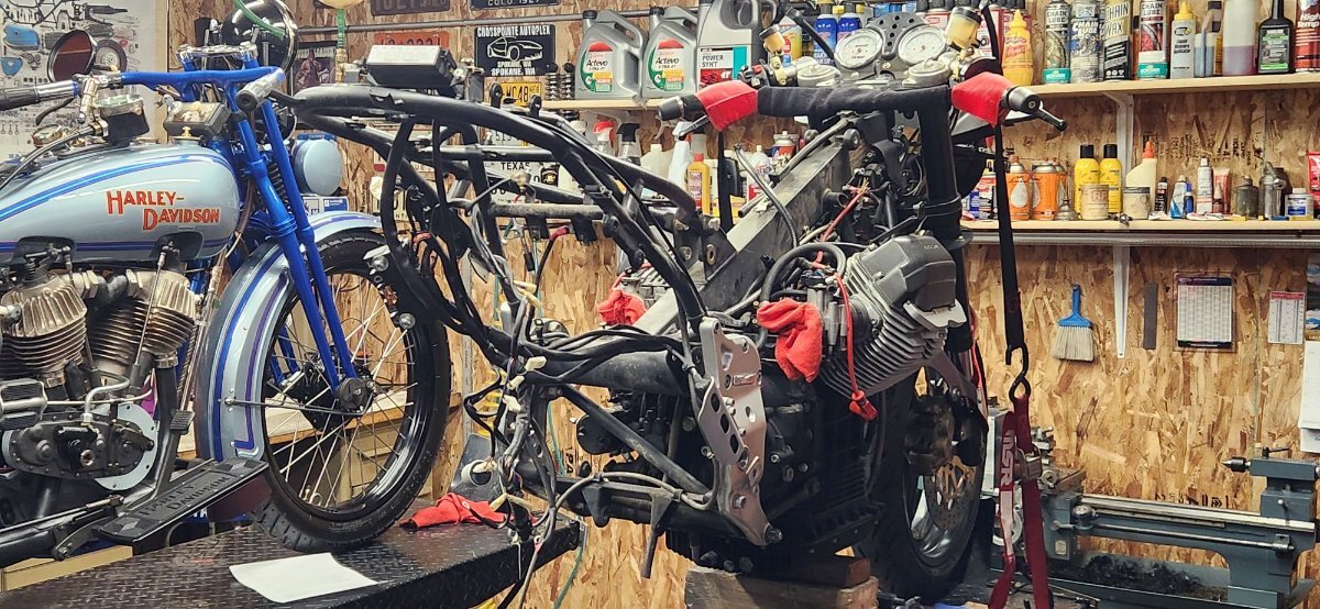

The old gal is outfitted. I did some modifying of the 1/4" alum.plate the po made brackets to fit the Give Wing Racks. The mounting hardware can now be removed as an assembly by removing 3 bolts on each side and now retains the factory rear blinkers. Not sure about that top case, wish it could be moved further ahead instead of being perched in the back 40. Now that i wrote this, i'll take a closer look for that possibility. Will be interesting to see what this kit feels like on the road loaded. -

My next project is coming up with some alternative of mounting the well designed brackets the p.o. had fabricated that attach to the Givi Monokey bracket and the whole mess attaches to the part of the frame the passenger/muffler brackes are held on by 2 Allen screws. I'll post pics when i am ready to experiment with the 130mm Allens that should be here any day soon. He had the brackets as close to the frame as he could get them and had installed some HORRIBLE round mufflers that were lower than factory and an extra bracket that looked like s--t, and the mufflers had one of the worst sounds i've ever heard a muffler make and certainly sounds no V11 deserves to have to make. Sort of a clattering, the first time i rode the bike i thought there was an engine problem or something flapping loose. Threw them in the metal recycling bin at work. I'm thinking the longer Allens will get the bags a bit further out so they clear the new satin Mistrals. -

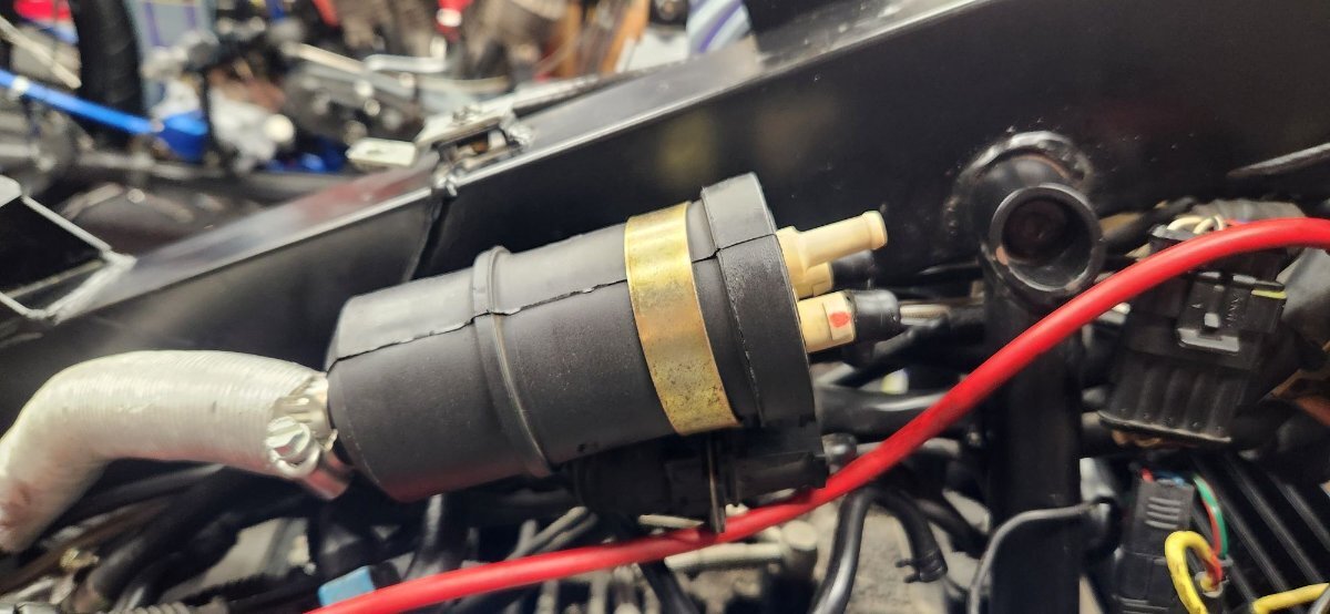

Thanks, @gstallons, THAT is a Great Point. I am certain you nailed it. i used the factory mounting rings and cut 3mm rubber strips from an MX innertube, but she's really tight in those clamps and i'll bet the 3mm strips simply are not enough cushion so now the pump, when in operation, resonates very nicely... Wish i could use the rubber cocoon the factory pump fitds so nicely in. There are used factory pumps on ebay, listed by a German salvager, only $175 or $250, as George Patton said, "Nuts." Hmm... Gonna have to come up with something different. And keep my eyes open for a reasonably priced factory pump.
