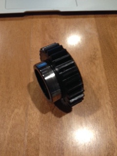

Yes... that is some nasty... but, if the input hub was loose, that was the problem...everything else is secondary. looks to me like you need everything that goes in there.( i would) flywheel - pressure plate- 2 clutch discs - intermediate plate - and an input hub. Let me know what size you have and I will check the other one I have. As far as how the wear on the teeth happens ... only a theory ... the springs only work in a "horizontal" attitude big v-twin with uneven firing pulses transmits torque in a manner 90ยบ to the springs springs working front to back -- clutch plates hitting side to side -- if sitting at a red light with the clutch pulled in...bang bang bang. if you sitting there in neutral, idling, not much going on. so much for the 1100rpm idle. mine has been around 900 rpm since forever. you must be cruising the square on weekends.....LMAO ( its a southern thing ) also I assume you got everything disassembled with out needing the flywheel lock ...if you think it will be an advantage upon reassembly let me know and I will get it to you .
