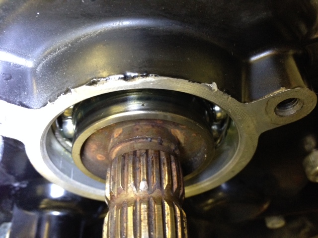

Pretty straight forward. Made an awl from old screwdriver and pushed it in there. Laid a thin 1" wide piece of steel under the fulcrim point of the awl so I would not damage the case. popped right out. Shaft was in great shape. put new seal in and put it all back together. no leak now /

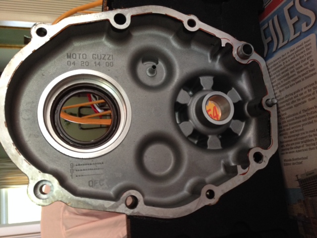

gearbox is popular these days. I cleaned mine up the other day and just ran a bead of sealer all the way round. Then fingered it to smear around and cover all of the shaft. Taking the side plate off is kinda useless if you can seal it from the outside, but to each his own. Some of the gear selectors were indexed some not. Some pairs have more teeth than other pairs. like Docc says, If you pull the cover,make sure your in neutral Now off to the output shaft seal -

I don't know. That plate is off a spare tranny I have. I would be careful "prying" on it. the bonding/gasket seal will need to be "broken", then things should give way quickly. Almost like giving content pressure,then more, then more. If you "wack" it with a hammer you might snap a piece off and that would suck. good luck
Just FYI, this is what you will find if you pull the cover . Just make sure your mating surfaces are absolutely spotless upon reassembly. Please use a torque wrench also. lol . Some Italian castings aren't as good as others,, and if you pull the threads on one of the bolts .... Well I'm glad your close to Teo lol I'm sure you will be fine. Just take your time and do it like you know its supposed to be done.
Well, everyone will have to wait a little longer. I may have determined that it is not leaking. It appears that I may have a little blowby from the tranny vent. I will take a few longer day trips and see what happens. My question back to you Bjorn is " If you could not pull the cover, how would you get it out"? anyway thats what old busted screwdrivers are for. Heat, grind, bend till you get it in the shape you need for the project at hand. And be very carefull prying it out----don't want to scratch or gouge the shaft . It is dooable tho
Hi Bjorn, You are correct. There really aren't that many pieces to fall out. Its probably a coin toss as to which is easier. BUT. I can probably rebuild the motor without taking it out of the frame, But I'm NOT. Just hate to see ya open it up to the environment thats all. specially if we can do it without taking the cover off. Even if I pulled the tranny I would not pull that cover off unless there is another issue.
Don't take the Cover off ! You will shat all over yourself when everything falls out. I going to pull the swingarm, remove all driveshaft componets, remove the protective cage, and see if I can install my new seal. Maybe have to remove the right side porkchop. Its either that or I will pull the complete tranny off. I'll let ya know later this week
