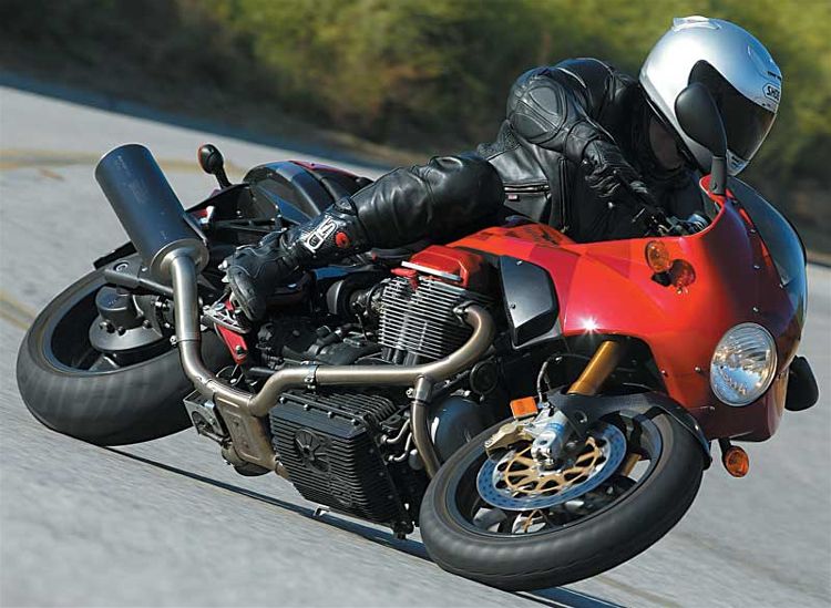

Here's a few more thoughts on a possible design. I bought this t-shirt a while back because the design on the front is a little like the LeMans. Something similar to this with a Guzzi jug in the artwork would be cool. Jaap's designs below are really nice but I'd like them more if the Guzzi head and cylinder could somehow be incorporated so the bike would look less generic. If I had some kind of graphics software (and 1/10th of Jaap's talent) I'd take a shot at it. I attached what I think is a good pic of a LeMans that could be a good basis for a design. All that said I still love the beer label design!
