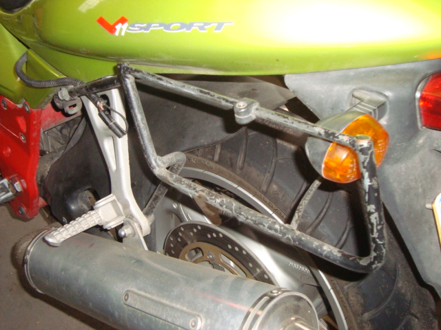

Nice shots Ken - looks like the bracket for the LM is different than the Sport at the exhaust / footpeg bracket. Yours is way cleaner too! Now I need to paint mine, and wash the bike etc etc ... thanks! Gio
No instructions (sorry) but here's a pic of left side on my V11S (same as LM as far as I know) that may help out ..? Not shown is the mounting on the underside of rear fender. Gio

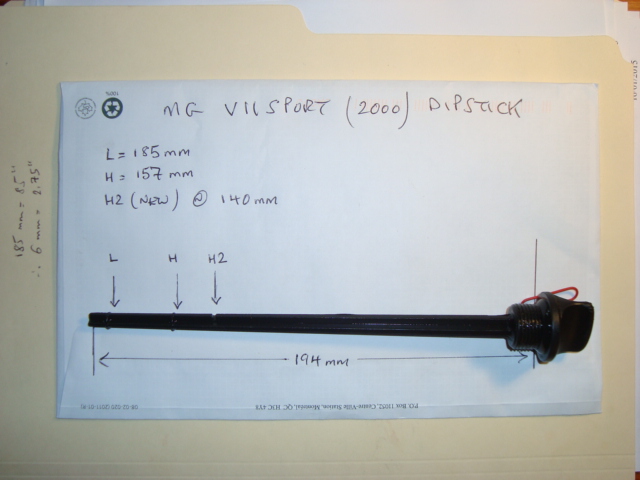

Here's a pic of the modified dipstick I refer to earlier (per PM request). With Roper plate fitted, bike level and dipstick screwed in, 3.8 l gives a level between H and H2 with no evidence of any over-fill. Resting my case now. Gio

The breather hose might be worth looking at - I had to replace mine a few years back (there is a post that gives good info on how to make a new one). Sounds like the PO was on the ball and would have no reason to question your confidence in that. But I think the key point I'm trying to make is that the stock dipstick measures ~12mm low (and have wondered if the idea might be to account for the threads on the stick - ie no need to thread all the way in to take a reading ..?) ... anyway, if I were you at the next oil/filter change I would fill with say 3.5l and find a way to keep the bike level (perhaps some blocks under the side-stand just the right side of balance point) and see where that came to on your dipstick ..? At least this would give you a reference point and hopefully validate the PO's mark. If (as I suspect is the case) you find that your stick is also reading low, then filling to any mark is not over-filling, but compensating for the dipstick marks.

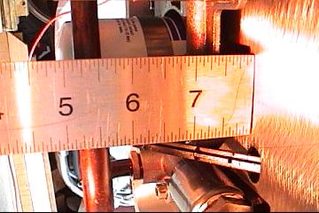

Firstly - I offer profuse apologies to those who may find attention to oil level and it's accurate measurement to be less than important on an air/oil cooled motor ... To clarify earlier comment, based on measurements made during installation of the plate, I (and others - Ryland I think?) concluded that the stock dipstick H mark was reading 12mm low with 3.5 l , so after fitting the plate (which added additional capacity) I made an additional mark "H2" and found that 3.78 l gave a level somewhere between the original H and H2. So I now use the stock H mark as my "low" and H2 as my "high" with a typical refill of ~ 3.7l after over-night draining + filter change. In US Qts I think that's about 3.7 also? So I think most of the increase in volume was from the low-measuring stick correction. This also correlated with early oil changes at the dealer where typically 3l was used (as measured by the stock stick). I attach a couple of pics which show the dipstick relative to the plate - the new level was measured with a dowel as ~2mm above H and ~13mm below the plate. I ride the bike hard (ie maximum slosh to the rear), have never seen the oil light come on or any evidence of over-fill. Gio
