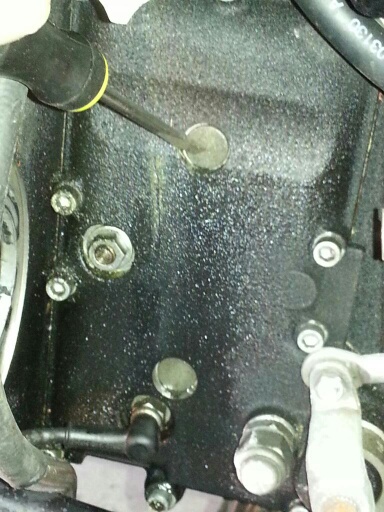

Could someone kindly confirm that this is the transmission vent? Not easy to get to even with my stubby wrenches. I'm assuming I remove the vertical portion as opposed to what looks like a plug facing rearward. Thanks. Attached photo should be rotated 90 degrees clockwise so vent is pointing up. -

Follow up report - took the Scura for a spirited ride over the weekend and after the first 50 miles, no leaks. But victory was short lived - another 50 miles and back in my garage I smelled the all too familiar aroma of gear oil burning on my crossover. The good news is it wasn't coming from the newly sealed shaft bosses, but now coming from the hole with the bolt head midway between the sealed bosses and to the left (see photo above). I double checked my gear oil level which is just a hair below halfway with bike vertical. So i'm now beginning to wonder if it is possible for the vent to get clogged, because that gear oil really seems to wants to escape one way or another. I'm not sure the best way to check for this or how it could get clogged, but if this is a known possible issue, kindly chime in. I can seal around the bolt with something less permanent than the epoxy used above like RTV gasket seal, but want to make sure its not building up more pressure than it is supposed to first.. -

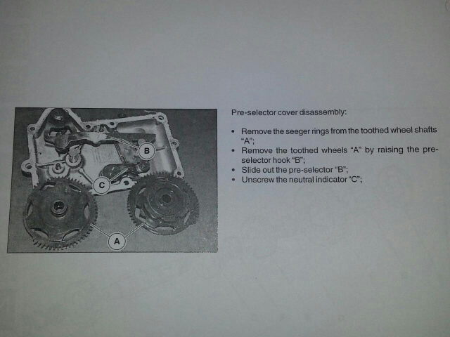

i found this photo ofo the inside of the side cover and instructions in my service manual (missed it first time around). Looks doable. -

Thanks AndyH. I just read all the Belfastguzzi threads - wow - very thorough and helpful. I did not see those threads when I did read all the other transmission leaks threads. His photos show the gears attached to the inside of the cover. I'm wondering how those come off, if they need to go back in the exact same rotational position, and if there will be any way to seal them. I see that Harper's sell a plate kit ($130) - I wonder if that comes with caps installed and properly sealed. I'll call them Monday and find out. Meanwhile, i'm of course wondering if there is an easier way out and if anyone has had any luck sealing the caps from the outside... -
Decided enough was enough with the slow drip from my 2002 V11 Scura transmission side case onto the crossovers. I removed the starter and found the leak not coming from the perimeter seal, but from the round bearing-looking items in the middle of the cover (see photo). So my first question is - what are these? Are there O-ring seals inside the side cover for them? If possible, I'd like to order whatever parts i need before i go much further. Also, what is the large cap nut just in front of the gear selector (see photo)? That will have to be removed before the side cover comes off - any precautions? Other than first draining the gear oil, is there anything i need to know before taking that side cover off? Any help or suggestions (especially from anyone who has removed there side cover) would be greatly appreciated. Thank you.
