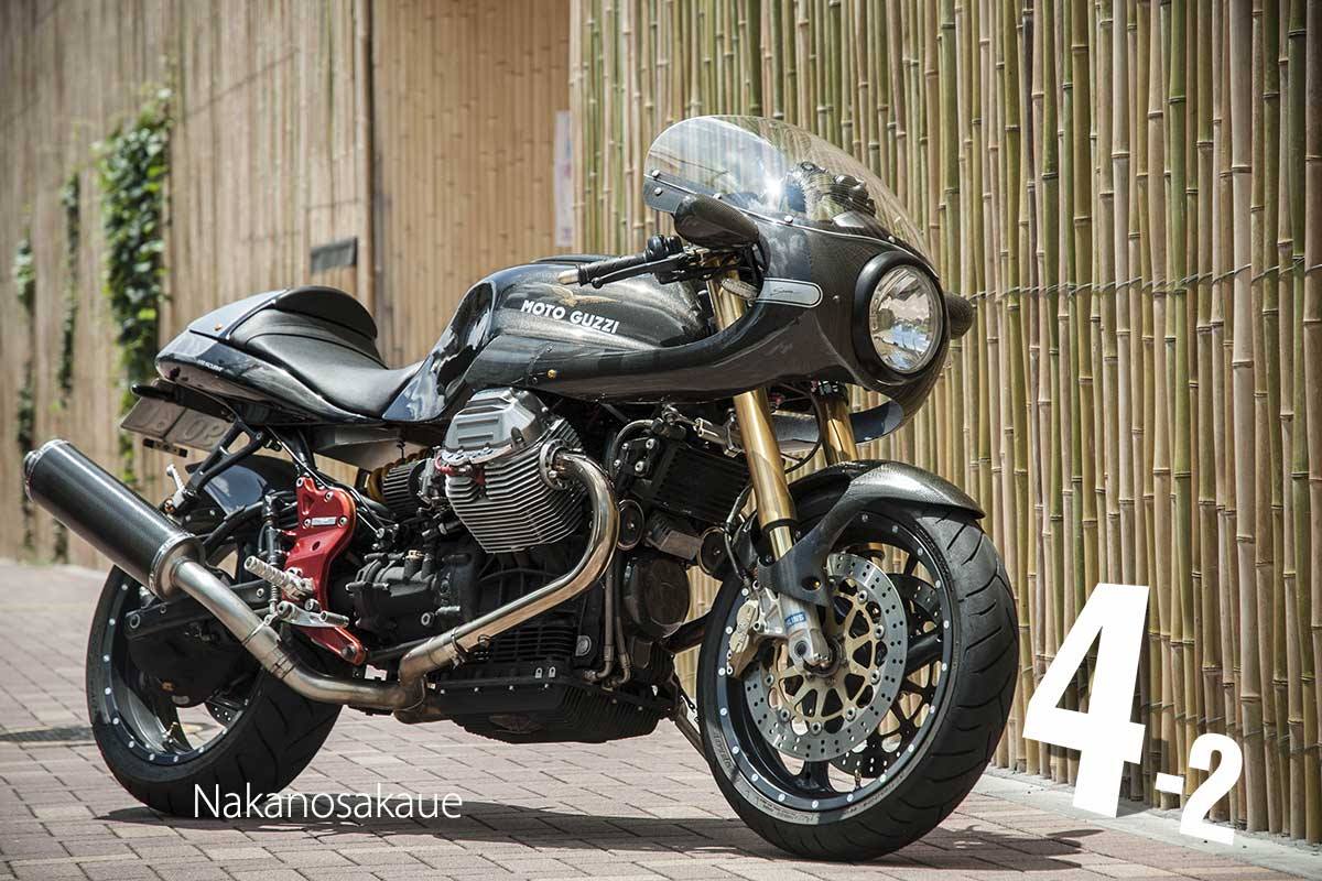

  15. Found this image on Pintrest - the owner calls his bike "Tokyo Short Trip". Love the fairing and want one for my Scura. Please let me know if you know where it can be bought - thanks!
