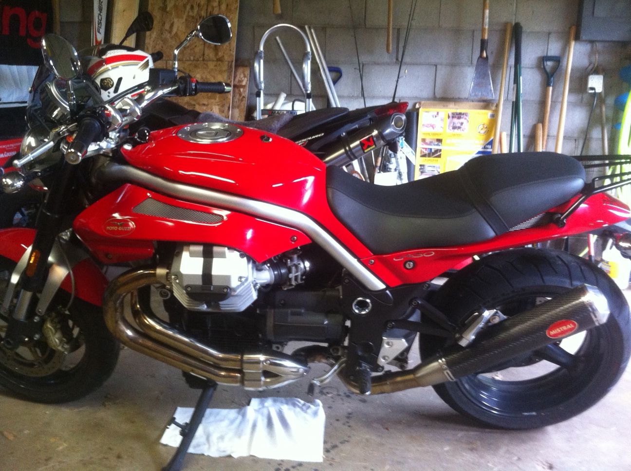

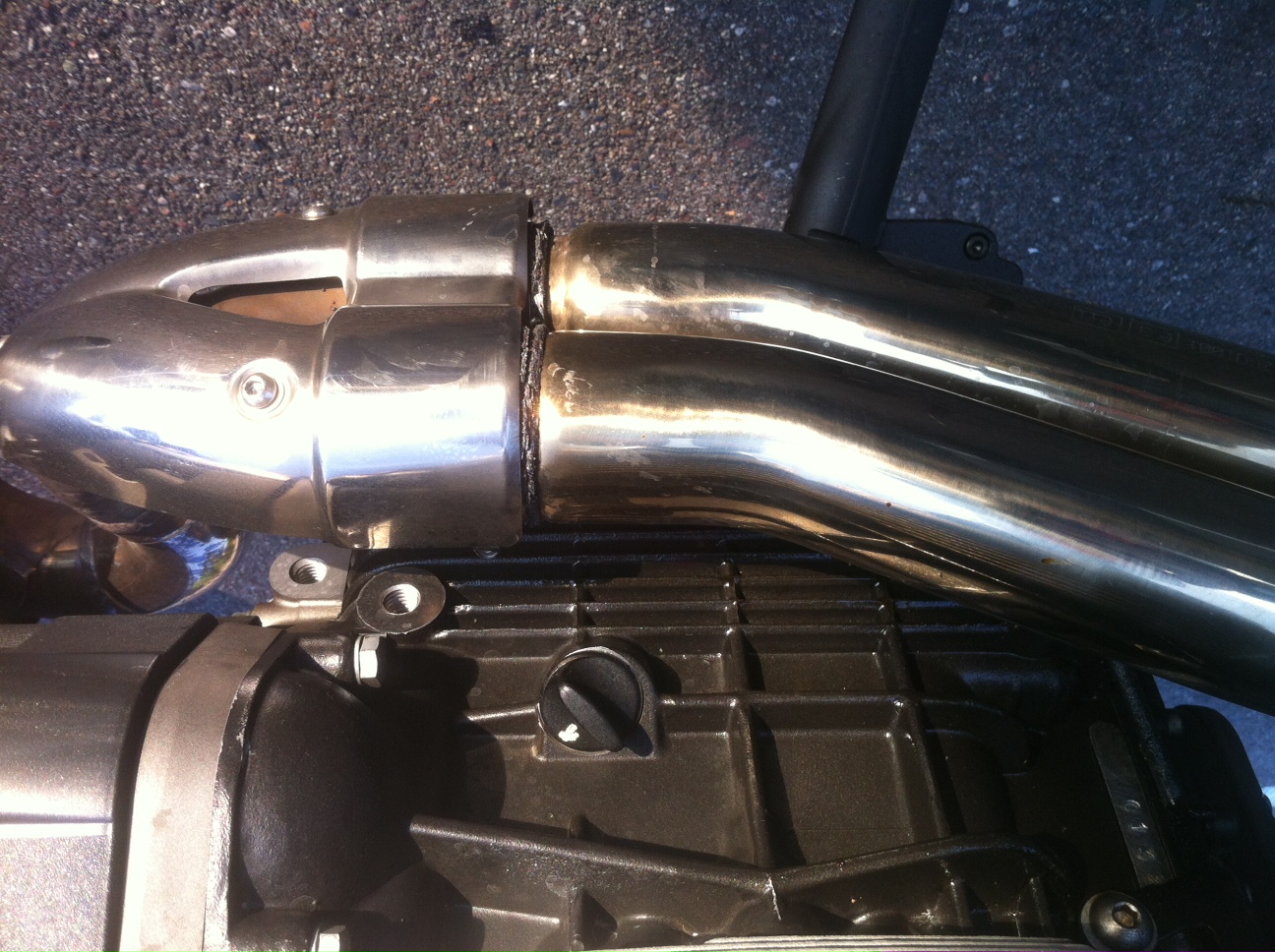

well just like the relationship with my dad the bike has a problem, after my 40mi ride home from the dealer the left side of the motor is covered in oil, appears to be a low pressure leak and its not the valve covers really appears to be the timing cover (which was starting to seep on my V11 when I sold it, karma I bet) I don't really want to take this bike back I loved the ride, smooth and more refined than the V11 yet still so visceral and mechanical. The thing only has 10k on it and $6500 with great upgrades a small oil leak shouldn't be a big deal right? I see it I only paid $400 for it.
Hopefully I get get some insight from here or call Mr Roper directly, maybe there are better quality gaskets I can use to replace?
I put those paper towels under the bike and it didn't drip all night but the engine is wet with oil on the left side. hard to get a good photo of that.

they don't work on or know anything about guzzi's which is part of the reason I got such a good deal, I'd rather do it myself the thing also had the tank breather valve on backwards(dummies) I talked with Pete roper and have a good idea what it is, how to fix it and it won't cost me more than $5 HELL YES

pete said its probably the phase sensor and that does appear to be where its coming from, hard to get at but east to fix, he suggested some locktite gasket making sealant, I could probably use an extra set of hands to get at it, kinda glad its not a timing cover gasket and can't wait to get some miles on this girl.

There are several threads on the leaky phase sensor which mimics a leaky timing chest. Look at this Oil Leak thread for a good time.
There is an O-ring on the sensor.
