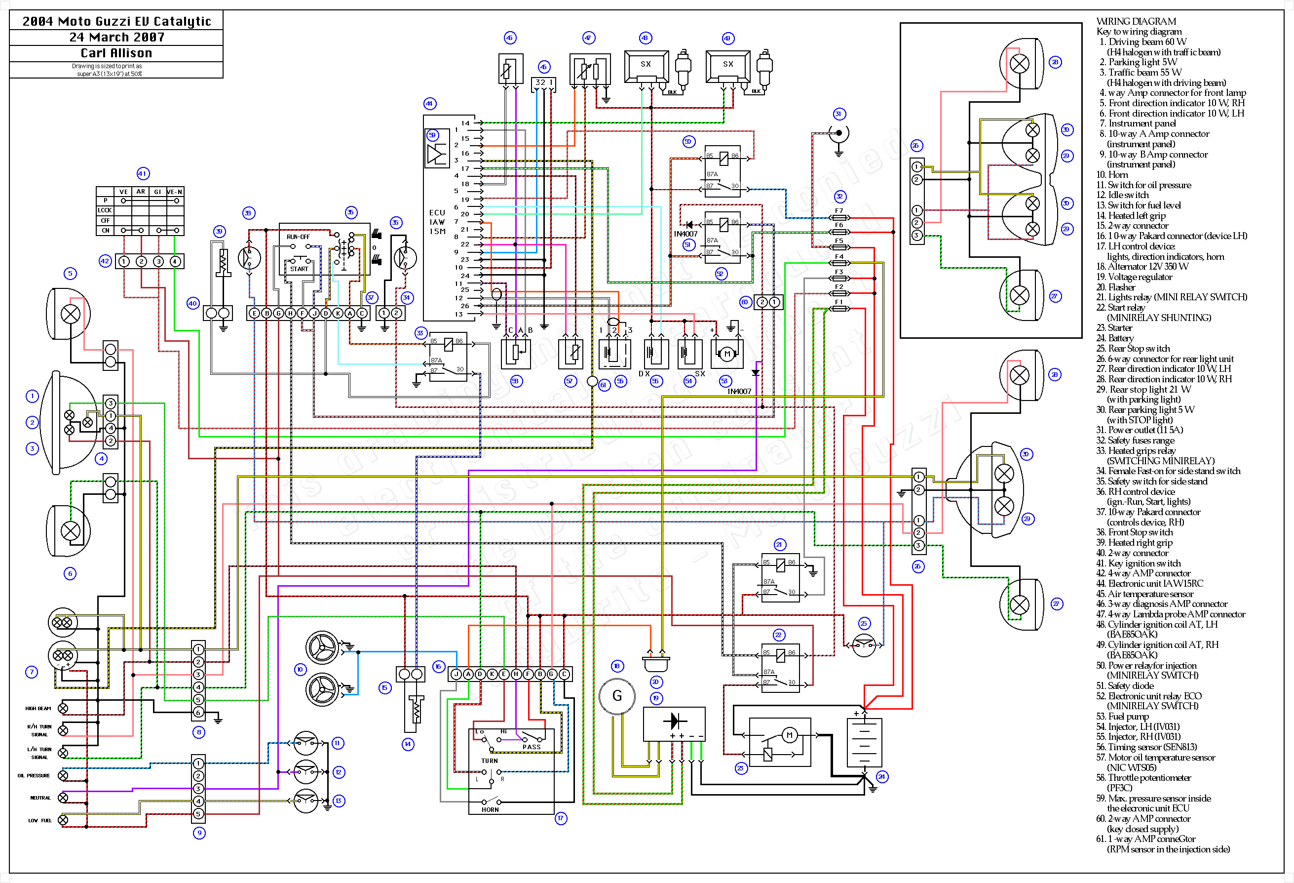

With aftermarket headlight relays the battery looses half a Volt because it no longer benefits from the voltage drop through the standard headlight circuit, (the regulator senses the Voltage downstream of the relay).
At one time Ken had a diode added to boost it back up to the normal level.
I think this era bike would probably benefit greatly by upgrading the regulator to one of the more modern ones where the connections are made directly to the battery Positive and Negative.
Such as this 2004 EV
http://www.thisoldtractor.com/guzzi007/schematics/2004_EV_Catalytic.gif
However I don't have any direct experience with these regulators, perhaps they also come with their share of baggage. :unsure:
