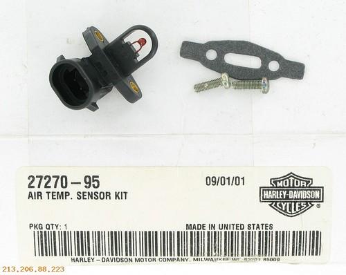

On a somewhat related note, after setting the TPS, I noticed the air temp on the VDST said 74f, but it was 37f outside at the time. I do have the open air box lid, so I'm thinking of either moving the air temp sensor, or going with a new lid with 3 holes drilled in it and the snorkels enlarged to 2" like posted in another thread on this site. I'm sure the air temp sensor is picking up engine heat at red lights, and causing the hiccup. Since I'm seeing over 15 AFR at red lights, I'm assuming that the higher air temp sensor reading is causing the bike to run lean?
I do have some extra thermistors from KiwiRoy (thanks!), so I can play around with mounting them in various places. I also found an air temp sensor with the proper housing at my local HD dealership for $25 and it had the proper ohm readings at various temps when I tested it. It's part #27270-95 which is close to their TPS part #27291-95. The dealer told me the -95 is the year bike that it was used on.
