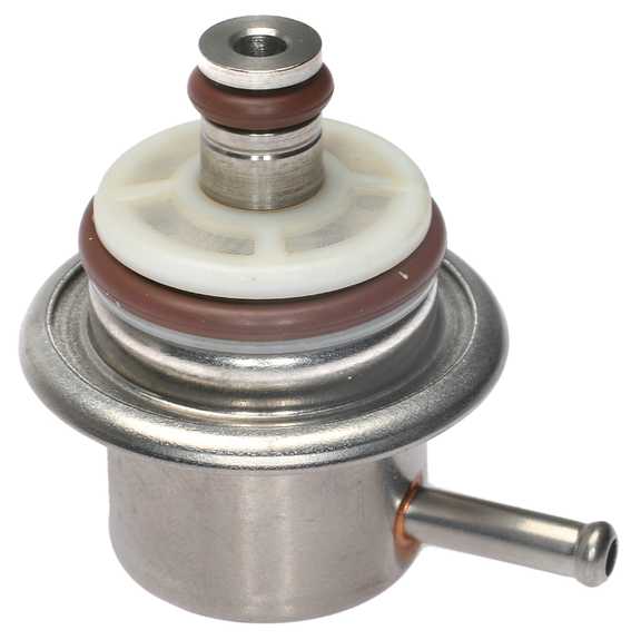

When I was looking up the fuel regulator, I found a pic for a replacement. If I'm looking at the correct part, it's on the lower RH side of the tank (by the petcock). I noticed that mine does not have a hose attached to the smaller nozzle. Is this normal? Pic is attached.
Nothing should be connected to that nipple.
As mentioned earlier, check your fuel petcock. The electric petcocks that were used in '00-01 have caused problems for some owners in the past. If they lose power the fuel pump can still suck fuel through it but fuel pressure will suffer and it could kill the fuel pump. A lot of owners replace the electric petcock with the manual unit from '02.
