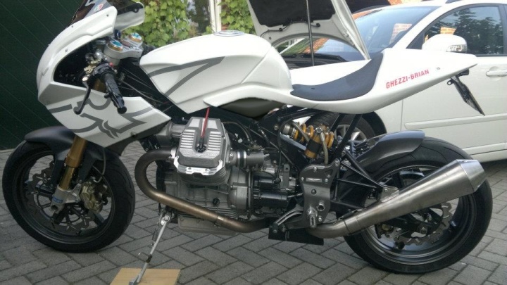

Admin Jaap Posted November 29, 2012 Share Posted November 29, 2012 It's relatively straightforward. You need a pre 2002 (red) front subframe and the 4V throttle bodies. You can use the V11 wiring loom, only the connector to the TPS is different. The 6 speed fits w/o problems. Link to comment Share on other sites More sharing options...
dangerous Posted November 30, 2012 Author Share Posted November 30, 2012 It's relatively straightforward. You need a pre 2002 (red) front subframe and the 4V throttle bodies. You can use the V11 wiring loom, only the connector to the TPS is different. The 6 speed fits w/o problems. thats awesome man, is it GB body work, which I asume you fitted to a v11 rolling frame and added a 4v engine? Link to comment Share on other sites More sharing options...
Admin Jaap Posted November 30, 2012 Share Posted November 30, 2012 Exactly. You can find the thread here: http://www.v11lemans.com/forums/index.php?showtopic=15561 Link to comment Share on other sites More sharing options...
Baldini Posted November 30, 2012 Share Posted November 30, 2012 Beautiful bike Excuse the presumption...added a bit of black or gunmetal...what u think? Link to comment Share on other sites More sharing options...
Admin Jaap Posted November 30, 2012 Share Posted November 30, 2012 Keith, what do you mean exactly? Link to comment Share on other sites More sharing options...
Baldini Posted November 30, 2012 Share Posted November 30, 2012 Keith, what do you mean exactly? Hi Jaap, In photo above, I just coloured lower front fairing edge, & panel at tank lower rear, black (or maybe gunmetal like s/a plates)on PC. To me, it brings out a simpler line in the bike. K PS: There is a Guzzi precedent! LM1 & 11 tank had black painted lower part, with a straight edge that emphasises the line of the Tonti frame top rail, & enhances the lines of the whole bike. I've seen bikes without the black, just a solid colour tank, & it breaks up the lines, doesn't look so good IMV. Just my . Link to comment Share on other sites More sharing options...
dangerous Posted November 30, 2012 Author Share Posted November 30, 2012 Beautiful bike Excuse the presumption...added a bit of black or gunmetal...what u think? i think its an improvment Link to comment Share on other sites More sharing options...
docc Posted December 6, 2012 Share Posted December 6, 2012 Of course, the bike is spectacular! But . . . taking a picture of it with a car of the same colour in the back drop with its bonnet propped up has to be bad JujU We will have to collectively quaff good ale to ward off the aspersions. For Jaap, we will all need to come together on this. I pledge my part! (PS: I do like the lines Keith added: very clean!) Link to comment Share on other sites More sharing options...
Admin Jaap Posted December 6, 2012 Share Posted December 6, 2012 Keith, thanks for the small paint scheme change. I didn't notice it at first. You are right, it looks better. Maybe a project for next year. ... But . . . taking a picture of it with a car of the same colour in the back drop with its bonnet propped up has to be bad JujU ... Dead battery after six months of only starting but not running the bike. Link to comment Share on other sites More sharing options...
