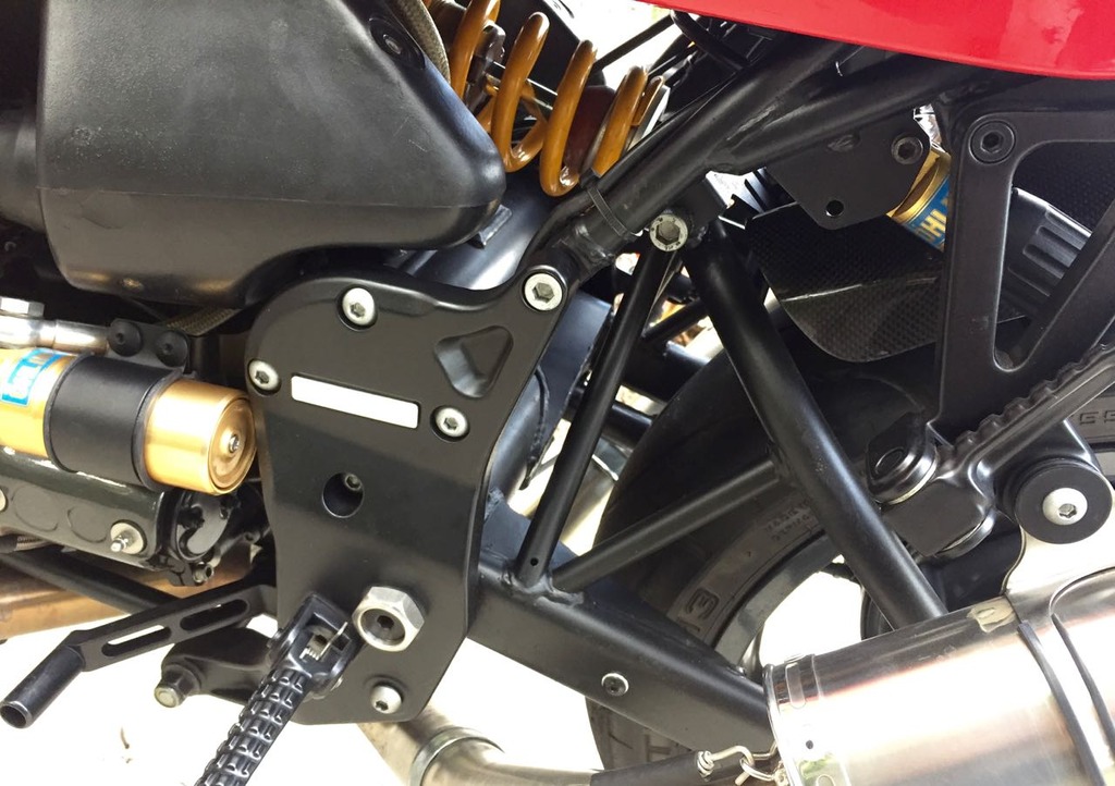

Scud Posted April 27, 2017 Share Posted April 27, 2017 Yeah - some people use helmet locks. I always take my helmet with me. And the seat lock tab makes a good mounting point for a remote shock preload adjuster. My K75s helmet lock and seat lock are both operated by the same key - so it gets to stay on the bike. 1 Link to comment Share on other sites More sharing options...
swooshdave Posted April 28, 2017 Share Posted April 28, 2017 Yeah - some people use helmet locks. I always take my helmet with me. And the seat lock tab makes a good mounting point for a remote shock preload adjuster. My K75s helmet lock and seat lock are both operated by the same key - so it gets to stay on the bike. What does the shock thing do that sits above the starter? Doesn't the same key work on your Guzzi? Mine does. Sent from my iPhone using Tapatalk Link to comment Share on other sites More sharing options...
docc Posted April 28, 2017 Share Posted April 28, 2017 What does the shock thing do that sits above the starter? Adjusts the shock's compression damping. As I recall it only affects the low speed inputs. High-speed compression (pot holes, road seams, etc.) are built into the valving and not adjustable. Setting the *clicks* 1/2 way should provide 75% of the compression damping (REF: Peter Verdone). On the original Sachs-Boge, rebound damping is adjusted with the anodized blue knurled knob on the shock shaft (same: 1/2 the *clicks*: 3/4 of the damping). Preload is adjusted using the anodized blue lock rings that are best accessed with the tank and airbox off (read: *not very accessible*). Link to comment Share on other sites More sharing options...
Scud Posted April 28, 2017 Share Posted April 28, 2017 My K75s helmet lock and seat lock are both operated by the same key - so it gets to stay on the bike. Doesn't the same key work on your Guzzi? Mine does. I wasn't clear, sorry. Yes the same key works everything on the Guzzi. But the Guzzi has two locks - one for seat and one for helmet. My BMW has a single lock that works the helmet lock and unlocks the seat - which is probably what nwrider was used to. Link to comment Share on other sites More sharing options...
