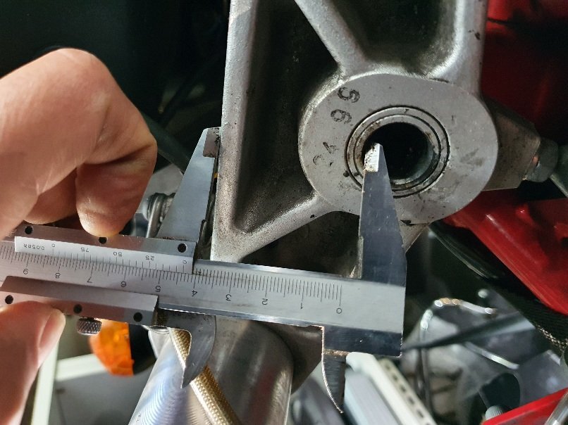

Lucky Phil Posted September 16, 2023 Author Posted September 16, 2023 So here is the definitive answer to the triple clamp offset question. Twenty years in the pursuit. This is what you get when you use a later top clamp on an early lower clamp with fork tubes fitted. The stem doesn't line up with the stem bore due to the different lower clamp offset. Another difference between the later and earlier lower clamps is the steering damper lug is 7mm longer on the later clamps so you need to machine that amount off the later clamps for the steering damper to fit correctly. 1 2
docc Posted September 17, 2023 Posted September 17, 2023 1 hour ago, Lucky Phil said: So here is the definitive answer to the triple clamp offset question. Twenty years in the pursuit. This is what you get when you use a later top clamp on an early lower clamp with fork tubes fitted. The stem doesn't line up with the stem bore due to the different lower clamp offset. Another difference between the later and earlier lower clamps is the steering damper lug is 7mm longer on the later clamps so you need to machine that amount off the later clamps for the steering damper to fit correctly. So, this conundrum is down to change in "offset" and not "angle" or "cant?"
Lucky Phil Posted September 17, 2023 Author Posted September 17, 2023 4 hours ago, docc said: So, this conundrum is down to change in "offset" and not "angle" or "cant?" Well if you change the bottom tree offset and leave the top the same then the fork leg bores need to be bored at a slight angle so they align. So now on the later forks the stem and the fork legs are not parallel. Just like an RC30 Honda and others for example. So the top and bottom triples are a matched set between the earlier and later. Phil 1 1
