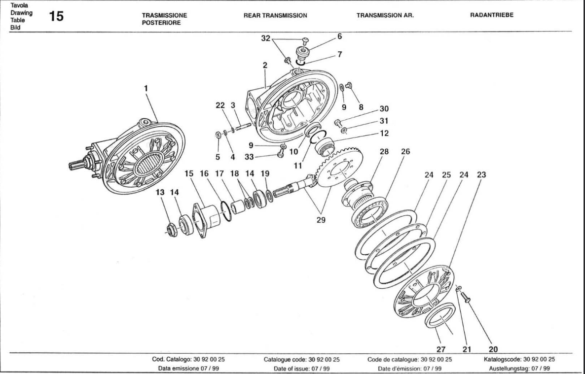

p6x Posted 17 hours ago Posted 17 hours ago Yesterday, May 10th 2025, I was doing some Motorcycle Texas tour stops. I was already 500 miles into it, and the plan was to overnight in Gladewater; When I got to the stop in Gladewater, I noticed the back of my Rimowa case was sprayed with oil droplets. When I looked at the final transmission. I could see it was all wet with oil, without any obvious origin. This brought back some memories, when I was looking to purchase a Quota in Boise. He did not have a rubber plug, like mine. He had installed an oil breather, connected to a long hose going through the chassis. Anybody has any experience of this happening on final transmissions of 25 years old Guzzi? this never happened before, and my last trip was 167 miles last Sunday. However, there was something different yesterday. I rode at higher speeds, since it was the late afternoon, and the road was mostly empty in East Texas. Maybe this was the first time since the oil change that the Quota was put through its pace?

p6x Posted 12 hours ago Author Posted 12 hours ago (edited) 1 hour ago, audiomick said: You could do either one, or just fill it back up and see if it developes any nasty noises. I dare say that if there is any serious damage in there, it will become acoustically obvious pretty quickly. If it's broken, it's already broken, and if it's not, continuing to ride it with fresh oil will not do any damage. As is, with no oil, no different noise that with oil.... To tell you the truth, the gearbox makes so much noise that it would be hard to detect a whining noise from the final transmission. But there is a ball bearing inside that final transmission; I lost item 33 and of course 9. 26 is a ball bearing. Since I had the IMS changed on my Porsche, I have learned that some Ball Bearings are sealed, and lubricated for the duration of their lives and the IMS fails because it was not meant to be lubricated by engine oil. It is a bit of the same with the wet timing belt issue. Those belts were never designed to be immersed in engine oil. I would not think this one is one of them. What really annoys me, is that I can't even check what type it is, because all you get is a Guzzi part number. As you see in drawing 16, 24, 25, 26 are shims. So there is an adjustment necessary if you take the final drive apart. I would have no idea how to properly set it up. Edited 12 hours ago by p6x

p6x Posted 11 hours ago Author Posted 11 hours ago 19 minutes ago, gstallons said: Buddy , you need to go over this bike w/a fine tooth comb and tighten EVERYTHING and top off all fluids. Well, I paid 1,788.18 dollars to MPH to go through the bike after I brought it here in H'town. I guess you just need to do everything yourself, which I would if I was properly equipped. I just ordered the oil plug; since none of the usual suspects had it in stock, I widened my search and purchased one from an auto part for 30 dollars delivered.... 30 bucks for a less than 1 dollar oil drain plug.... but it is made in the USA...
audiomick Posted 11 hours ago Posted 11 hours ago (edited) 48 minutes ago, p6x said: ... As you see in drawing 16, 24, 25, 26 are shims. So there is an adjustment necessary if you take the final drive apart. I would have no idea how to properly set it up. Yes. I took the final drive from my V35 Imola to the workshop when I rebuilt it for exactly that reason. I feel it is a job that should probably be done by someone who has a bit of experience, and has a "feel" for it. And a bucket of shims to swap them in and out until it is right. Having said that, I gather it is not actually all that difficult. The older workshop manuals explain it fairly well. For instance here, on page 93. https://guzzitek.org/atelier/gb/1000/1000SP_G5_Atelier(F)V3.pdf PS: I think there are also a couple of "special tools" involved. Edited 11 hours ago by audiomick 1
