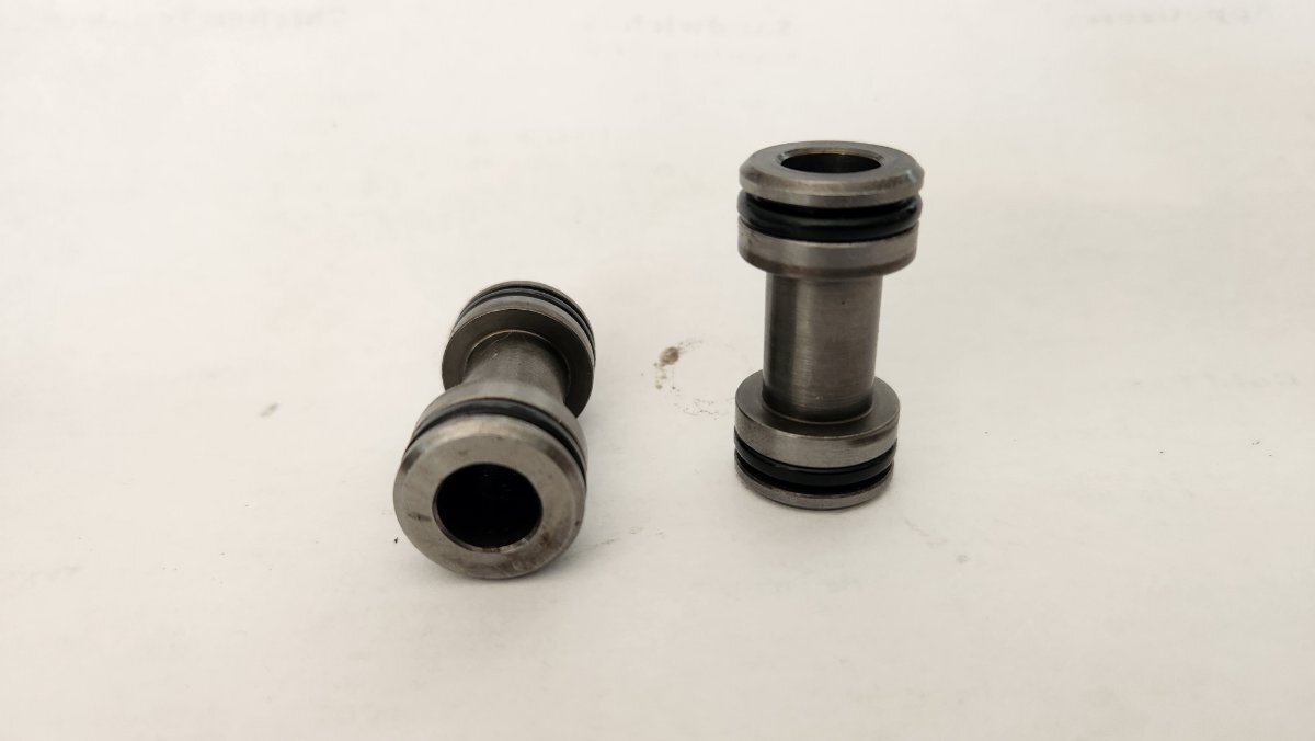

Two of these came in the box with an oil pan adaptor ring I bought
 What are they?
Put new correct good orings in for good oil presure. They are located in front of your intermediate plate.
Cheers Tom.
They go between the oil filter/distribution module and the intermediate ring.
Phil
  • Thanks 1
To be clear, they carry oil from inside the engine to the oil cooler hose connections on the outside of the sump ring.
