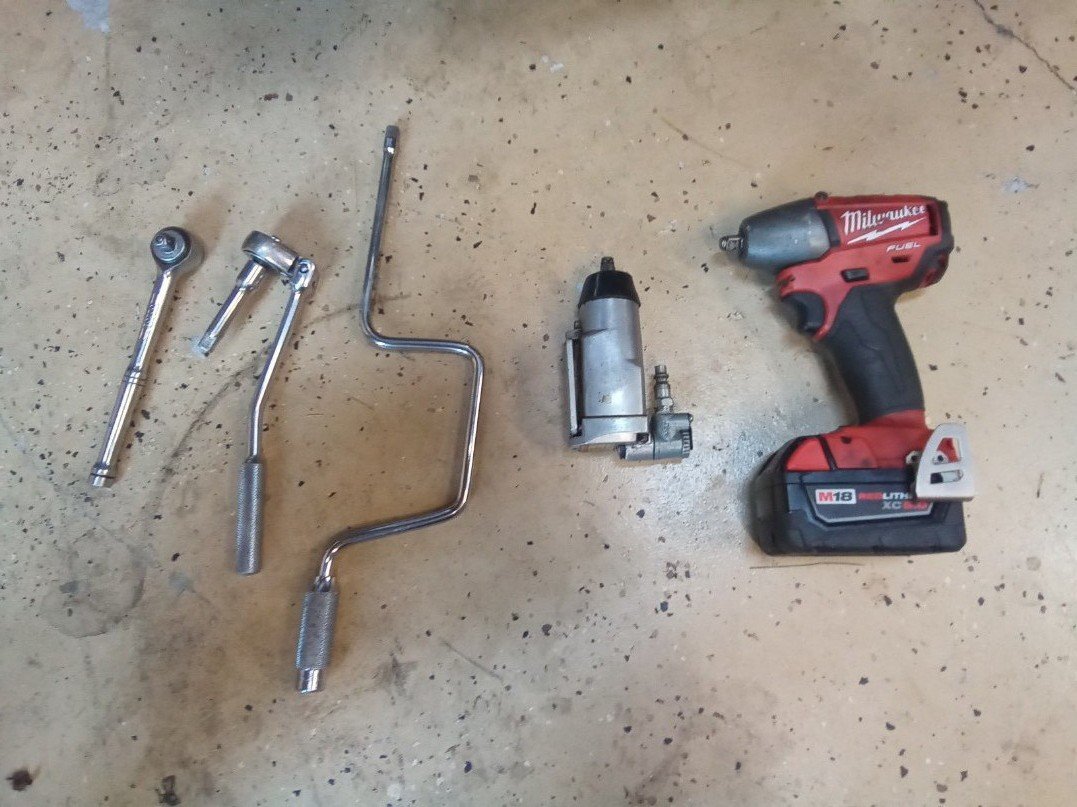

Pressureangle Posted July 20 Posted July 20 15 minutes ago, HRC_V4 said: I downloaded the instructions Pete wrote that is on This Old Tractor site. I might put this off a little while, the Quota rear brake is giving me issues and the little oil leak is getting worse, so that is first, still have 8 weeks of hot weather, so plenty of time before Fall gets here. Quick question, would a motorcycle jack with the big base (Hobo Freight) be good for the crabbing? Or just re-use my box I built for the loop frame? The one tool that seems critical to every 'Guzzi job is the scissor jack from a cheap car. I can position the jack in any place under the motor to adjust; front wheel, rear wheel, and it's slow and infinitely adjustable. Seems the flat jacks are too bulky, always in the way, and want to pull my front tire out of the clamp or jackstand. I welded a 3/8" drive socket on the cranknut to make it easy with a speed handle. 3
docc Posted July 20 Posted July 20 2 minutes ago, Pressureangle said: The one tool that seems critical to every 'Guzzi job is the scissor jack from a cheap car. I can position the jack in any place under the motor to adjust; front wheel, rear wheel, and it's slow and infinitely adjustable. Seems the flat jacks are too bulky, always in the way, and want to pull my front tire out of the clamp or jackstand. I welded a 3/8" drive socket on the cranknut to make it easy with a speed handle. " . . . a speed handle. " . . . . 1 1
HRC_V4 Posted July 20 Author Posted July 20 3 hours ago, docc said: " . . . a speed handle. " . . . . Assuming an impact to raise and lower it. Have several of the scissor jacks around so I'm good with that, even without the speed handle. 1
Pressureangle Posted July 21 Posted July 21 4 hours ago, docc said: " . . . a speed handle. " . . . . For those OGs who grew up without air compressors. 2
