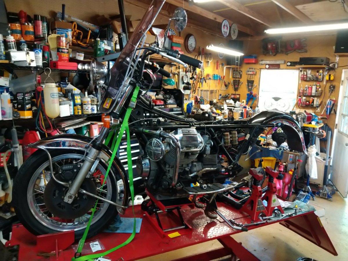

I finally bought my in-between Guzzi, between the Quota and the Ambassador.  It is a 1983 California II, bought it for $700 and have spent the last few weeks getting it back on the road.  It has cleaned up much better than I thought it would, it only has about 20k miles.  It sat since roughly 2000, last NY registration was 1999, the tires were Pirelli MT68 tires from 1992. Originally a European bike, it has T3 or Convert spoked wheels, had to respoke the front wheel due to rust.
It is running great, but can't really ride it since the clutch is stuck, it won't disengage from the flywheel.  The lever and mechanical linkage all seem to be working correctly.  I started it, let the bike roll down the driveway, put it in gear and rode it up and down the street with the clutch lever pulled in applying both throttle and brakes trying to get it to break loose. It is still stuck.
Does anyone have a good trick to break the clutch loose?

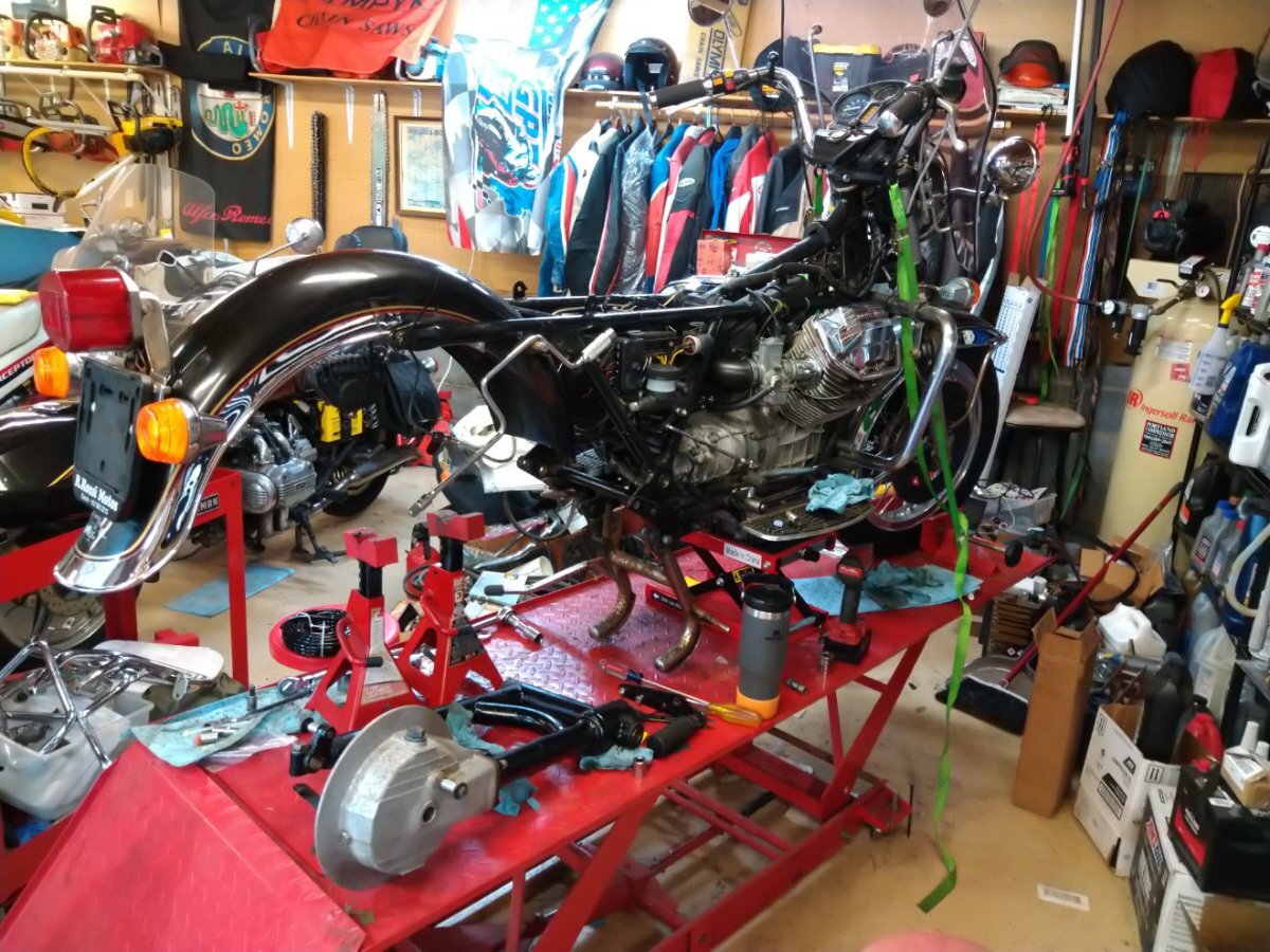

If it’s not breaking free it’s time to pull the gearbox. It’s not going to fix itself. It’ll allow you to fix all the usual crap in the bell housing at the same time and shim the gearbox for good measure.
  • Like 2
Same as our V11, yah, @pete roper?
I've read a little about crabbing the Tonti, I guess that is where I am heading.  Help me understand what to expect, I am guessing I can separate the trans from the engine with the stuck clutch, but removing the clutch from the flywheel is going to be the trick?  What needs to be addressed while I am in this far. Should I soak the clutch with penetrating oil before hand, seems like I will need to replace it anyway...

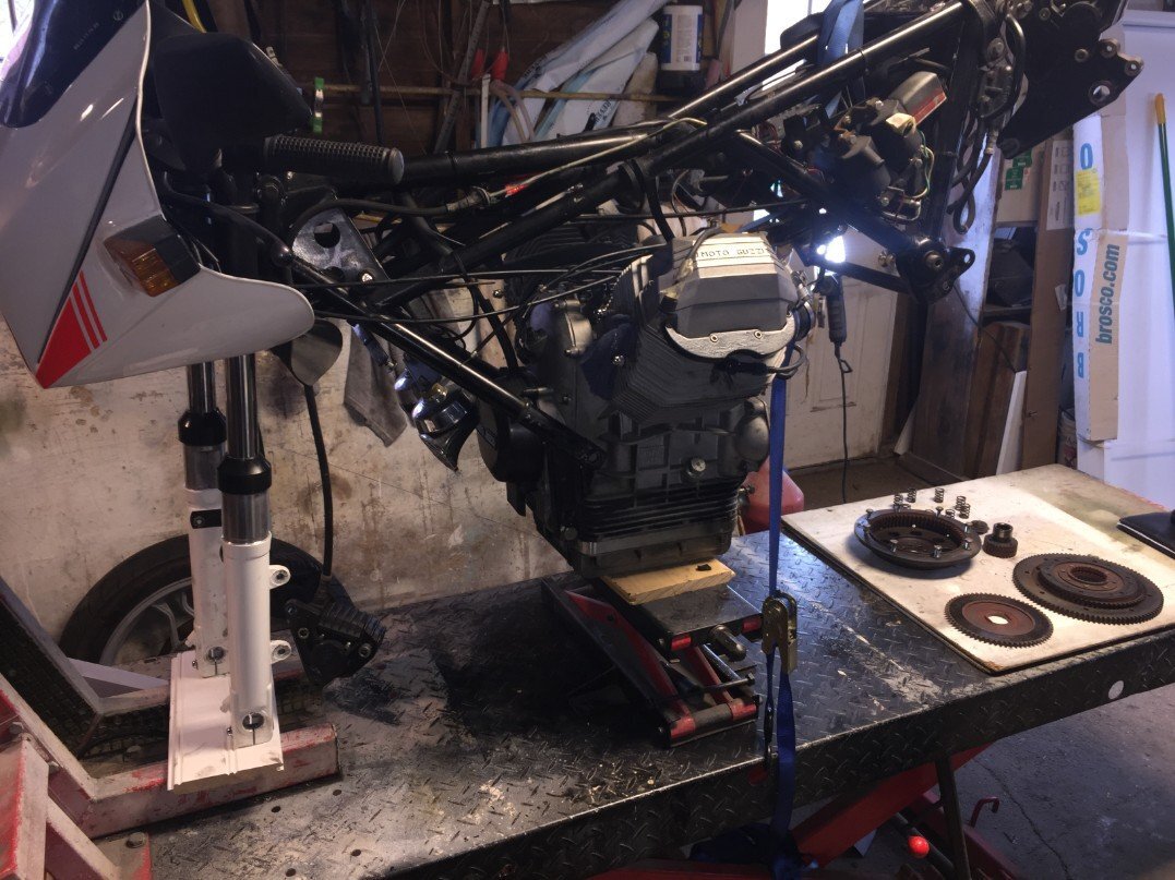

Tonti is pretty east to put a clutch in. Tank off, Pull the swingarm, wheel in if you have the hands. Trans top mount, loosen the front mounts. A few fasteners here and there like the battery box. Be sure anything strapped too tightly to the frame is released, and pull the frame up far enough to get at it. Starter, ground wire to the trans (hopefully, if not put one) Of course, you have to stabilize and secure the front wheel and block the motor sufficiently to wiggle the frame 'off'- unless you're stronger than I am you'll want some sort of hoisting mechanism to a rafter (in my case, open garage door braces on a 600lb hurricane rated door) as the whole event gets less than stable as it goes up. The only special tool you'll need is a clutch alignment tool. I'm pretty sure there are complete writups with photos on Wildguzzi.com.
As for releasing the stuck plates, everything will come to hand easily enough, then you can attack it on the bench with increasing zeal and chemistry until it's apart.
  • Like 2
I downloaded the instructions Pete wrote that is on This Old Tractor site.  I might put this off a little while, the Quota rear brake is giving me issues and the little oil leak is getting worse, so that is first, still have 8 weeks of hot weather, so plenty of time before Fall gets here.
