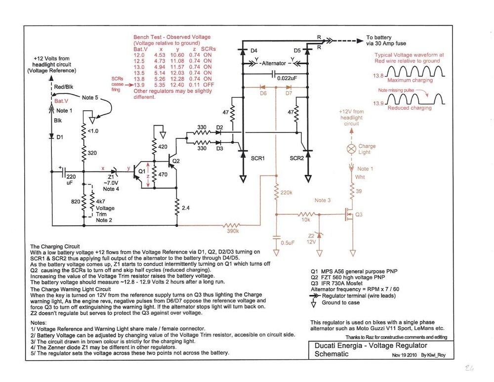

gstallons Posted Thursday at 12:07 AM Posted Thursday at 12:07 AM 22 hours ago, audiomick said: We don't have a schematic for the installed Electrosport regulator, so that might be the case. Referring to the @Kiwi_Roy schematic for the original regulator, I understand it that the warning light can only go on when the charging voltage is below the reference voltage. I'll attach another one of Roy's schematics, the same as earlier with notes. Referring to that, the charge warning lamp is switched on by a Mosfet that is switched on by the reference voltage, and switched off when the diodes D6 and D7 leak enough of the reference voltage into the negative phase of the alternator. Assuming that the Electrosport regulator operates in a similar fashion, I can't see how an overcharging situation would cause the charge warning lamp to go on. Maybe the functional principle is different, though, and overcharging could cause the lamp to go on. But then, why doesn't it go on right from "engine start", and why doesn't it light up with key on, engine off? My apologies , the MOSFET Q3 turns the charge light on. When the voltage is satisfied , Q3 turns off and light goes off. forginve my ramblings about difference of potential . This is from a long time ago. 2
Pressureangle Posted Thursday at 03:41 PM Posted Thursday at 03:41 PM 15 hours ago, gstallons said: My apologies , the MOSFET Q3 turns the charge light on. When the voltage is satisfied , Q3 turns off and light goes off. forginve my ramblings about difference of potential . This is from a long time ago. Yeah, that's where I started too, until Kiwi Roy's schematic showed up. I confused myself and the thread, but hey we're all learning together. I guess I *can* change my charge lamp to LED. 1
audiomick Posted Thursday at 05:25 PM Posted Thursday at 05:25 PM (edited) 22 hours ago, gstallons said: My apologies , the MOSFET Q3 turns the charge light on. When the voltage is satisfied , Q3 turns off and light goes off. Yes, at least in the one in Roy's schematic. We don't know for sure how the one from Electrosport that @Sam P has installed works. That's why I suggesed he check resistance between the warning lamp connection on the regulator and ground at key on, engine off, and then with the engine running at various speeds. Seeing what happens there should show what the lamp should be doing, and thereby give an indication of whether the lamp itself has a problem. Edited Thursday at 10:53 PM by audiomick 1

audiomick Posted Thursday at 11:01 PM Posted Thursday at 11:01 PM 4 hours ago, docc said: It occurs to me that addressing the charging problem would be primary. Once it is charging, the light behavior may take care of itself. I'm not convinced about that, although, of course, you may be right. Much thought on the topic has led me to believe that the light might have some intermittant defect that is making it difficult to see how the charging problem is behaving. The "voltage at the battery" values that @Sam P has confirmed, i.e. 13.x key off, 12.3 or so engine running regardless of r.p.m., indicate that it is never charging. The charge lamp, however, indicates that it is only failing to charge at revs above 4k. That is why I want to know whether the regulator is switching the contact for the warning light to ground always, or only at the higher revs, i.e. if the warning lamp is doing what the regulator tells it to do, or if the warning lamp has a fault of its own, independant of the charging problem. 1

gstallons Posted Thursday at 11:53 PM Posted Thursday at 11:53 PM I hope on this forum (somewhere) Kiwi_Roy had a schematic of the Ducati Energia VR (dated 11-19-2020). This diagram is on this thread and the V11sport schematic (also Ducati Energia dated 06-02-2020) .These are not the same. I had these printed off and put in a binder. These two regulators have different internal circuitry. Also there is diagram and test procedure (V11Ducati regulator problems. This diagram shows two red wires joined together , two yellow wires and a white wire and a black wire coming from the regulator.
gstallons Posted Thursday at 11:56 PM Posted Thursday at 11:56 PM 6 hours ago, audiomick said: Yes, at least in the one in Roy's schematic. We don't know for sure how the one from Electrosport that @Sam P has installed works. That's why I suggested he check resistance between the warning lamp connection on the regulator and ground at key on, engine off, and then with the engine running at various speeds. Seeing what happens there should show what the lamp should be doing, and thereby give an indication of whether the lamp itself has a problem. The light (I think) cannot be responsible for the problem but it is best to know for sure.
