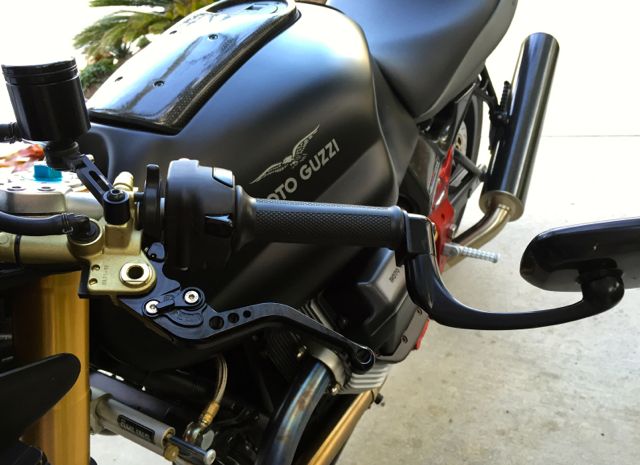

Scud Posted April 21, 2015 Share Posted April 21, 2015 I just received and installed a set of short Pazzo levers from MotoMummy.com (on sale for $149 and free shipping). MotoMummy would not advise me or show me pictures of the levers due to "liability reasons." But I decided to give it a go anyway and pretended that I had a 1998 Ducati 748 (always liked those...). The Pazzo part numbers are DB-12 (Brake) and DC-12 (clutch). The order came with a list that specified 10 different Ducatis that they fit. I edited the list from the above post to match the information I received. Monster M400: 1999-2003 Monster M600: 1994-2001 Monster M 620: 2002 Monster M750/M750IE: 1994-2002 Monster M900: 1994-99 900SS: 1991-97 748: up to 1998 916/916SPS: up to 1998 ST2: 1998-03 ST4/S/ABS: 1999-02 Several other Ducatis use the same clutch lever, but a different brake lever. I only listed the bikes that show both levers the same as what I installed. Here are the short Pazzos next to the stock levers. The contact points are exactly the same. They work fine and they make correct contact with the clutch and brake switches. I adjusted the actuator-screws so they stuck out the same distance as the stock levers. And here's a pic of one lever installed. Not even a remote possibility of interference with the bar-end mirrors. Happy hunting for cheap used replacements or shiny aftermarket levers. Duc Duc Goose. 1 Link to comment Share on other sites More sharing options...

Lucky Phil Posted April 23, 2015 Share Posted April 23, 2015 I use the same levers on my Ducati 2003 1000ss, 2000 V11 and 2001 Ducati ST2. Ciao Link to comment Share on other sites More sharing options...
Cabernet Posted April 24, 2015 Share Posted April 24, 2015 I went to a Pazzo distributor on the V11 and he identified a Ducati system and I rode away with them on the bike. I went for a red/black combination, the red matching the footrest hangers and now my clock mount too. The Pazzo rest easier in the hand giving a crisper, cleaner feel adding to finesse in control, particularly the clutch. Link to comment Share on other sites More sharing options...
