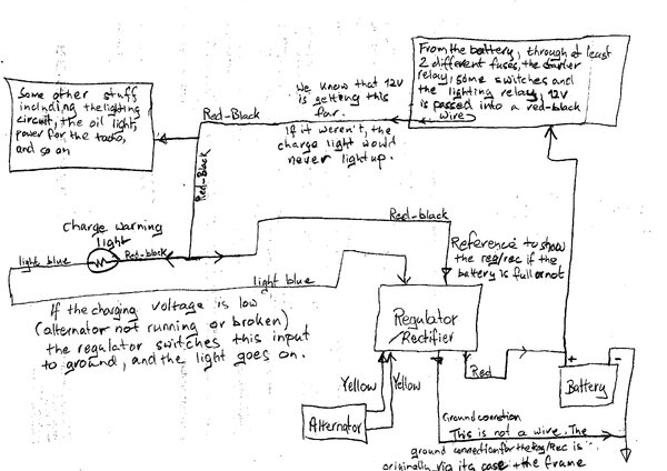

Update from yesterday evening: Plugged relay 2 back in. Battery terminals read 12.7 key off, 12.6 key on, 13.0 when I took it off the tender about an hour ago. Blue wire to harness 12.4v key on Red/black wire to harness 12.2v key on Re-attached harness black regulator ground. (Because the wire was not long enough to reach the regulator bolt, I attached it to the timing case bolt, from where my new 10AWG regulator ground goes to the regulator case). Next, with key on engine off, the headlight comes on, horn works, neutral light on, but no charging light or oil light. Main battery ground from gearbox seems intact, but there are a few sharp bends just before it attaches to the - terminal. I could try to eliminate the bends if it is recommended.

Relay 2 , when it is energized powers up the low fuel , oil press. and gen. lights. It powers up the tach and these lights and other components. When you install the #2 relay and turn the switch to run position the headlight should come on proving the relay circuit is working and the instrument lights mention should come on too.
Oh crap, Relay 2 was not installed, sorry about that. Will reinstall the relay first thing tomorrow, and redo the voltage tests on the blue wire, as well as the red/black wire from the harness. Stay tuned and thank you again.

And that is with all of the relays installed? That harness red/black is the voltage reference to the regulator's black (input) wire. Should be battery voltage coming out of Relay#2 . . . edit: Both the blue and especially the red/black wires look rather kinked going into the back of that connector. If they are straightened, or "wiggled", does the voltage change?
Zero volts key off and key on, engine off.

SanP , on my red frame the two red wires form one pin and they go into the red/green wire on the bike. The black wire goes down and grounds to the regulator mount.
Voltage on the red/black wire, KO/EO?
Zero volts on the blue wire. Battery terminals are at 13 volts
Well docc , the red/green wire is the wire that goes to F3. and I ASSUME the black wire is the ground to the battery. Let me go o/s and check my red frame to say yes.

OK tomorrow morning I'll reconnect the original reg ground (leaving my new one in place) and inspect the main ground from the gearbox all the way to the battery. Then I'll see the charging and oil light come on when I turn the key. I also may fire it up and take a 5 min ride around the neighborhood to see if anything has changed. If not I'll pull off the tank. Stay tuned, and thank you again for all of your help!
According to wiring diagrams , the regulator has a ground wire coming out of the regulator and going to a GOOD engine ground and at the same connection a good ground going to the - post of the battery.
Cleaning and securing that main ground along with restoring the regulator's harness ground can't hurt. Next, we are going to have investigate the connectors under the tank.

This makes me wonder about the primary battery negative ground to the back rear of the gearbox. Has that been seen to?
Yes R-G is the old reg to batt + charging wire. If I remember correctly, the black wire is/was the regulator ground back to battery -. Since I ran a new 10AWG ground from the reg case mounting screw to the timing case, I assumed I could cap the old ground wire. I could of course reconnect it if needed.
Okay, voltage reference wire is intact, then. What are the two wires truncated (nutted) in the image? Red-green would be the charging back to the battery through Fuse#3 you bypassed. But the black wire? Even with the case grounded to the timing chest, there would be nothing wrong leaving that regulator ground connected to the battery negative terminal.
