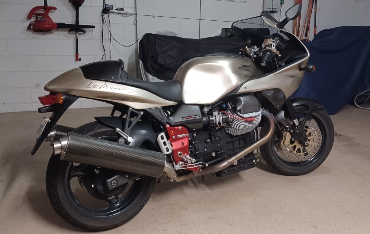

  7. that is exactly what i want to do. i want to have the valve covers changed to red, and the footpeg plate holders to the dark matte silver colour. so the valve covers would be the only thing red on the bike, and pop, like you said...
