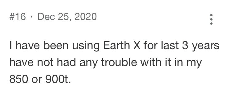

Fair enough - but in that case just get a LiFePO4 snowmobile battery - massive CCA & designed for extreme cold starts.
Operating Temperature
-30 °C to +60 °C
Capacity vs Temperature
25 °C = 100%
0°C = 94%
-30°C = 88%
https://earthxbatteries.com/product/etz14c/
EarthX seems to have an worthy reputation on snowmobile forums.
  • Like 2

I acknowledge your experience sticking with AGM - but it’s also worth seeing the snowmobile guys er.., gelling well with them. 🤤
They obviously can work just fine in subzero conditions - & speaks volumes as it would be more life threatening to get stranded out woop woop in the snow!
But as you say… “YMMV”
