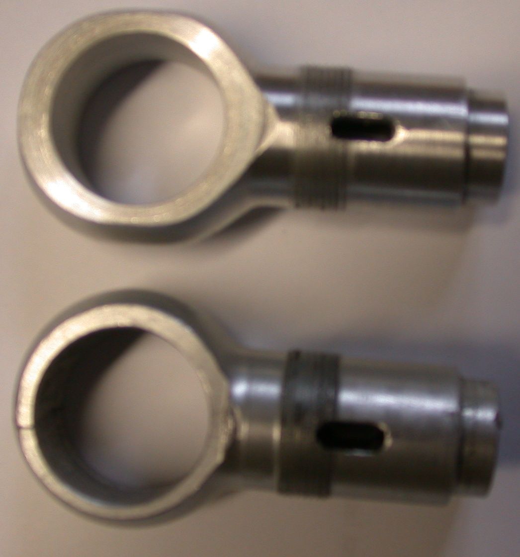

# A friend at work (The Bouncing Czech as we call him ) told me that he could get a shock eye made in Czech easily, so I let him take the broken part with him when he went home for Christmas. He has just got back from another visit and collected the finished part while he was there, the guy that did it has used aviation spec alloy and increased the thickness of the eye part slightly, not bad don't you think. It could be worth getting one made 10mm longer to give Ohlins like ride height , although the total travel would still be 10mm shorter than an Ohlins of course.

With mine the alloy cracked again down the full length of the thread when I removed it from the shaft,it was thread locked and the alloy let go first ! I can only assume that the alloy is to wrong for this application and the corrosive expansion of the alloy and steel around the shock eye is enough to cause failure.A dry climate and grease to waterproof rather than lube the eye would reduce the risk, wet, salty conditions (a British winter ) would make it almost certain to fail. The best we can do is keep the rear wheel spray off the shock and grease the area between the eye and the alloy ,it may be possible to remove the eye from the shock clean any corrosion and grease it but the risk of the casting cracking may be too great, anyone want to try ?
