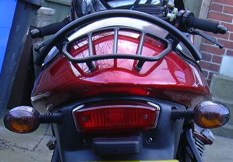

Headers are just cleaned and polished up (scotchbrite,1200 wet and dry,and metal polish), the rack if I remember correctly is from http://www.motomeccaspares.com/ search for "Carrier V11 Sport Black" there isn't a picture but I'm pretty sure thats the one.

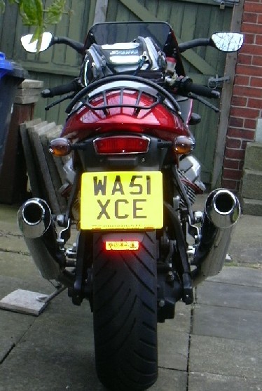

As you can see there are no baffles in the cans !! I made new hangers and a new X-over bracket using a car exhaust mount.

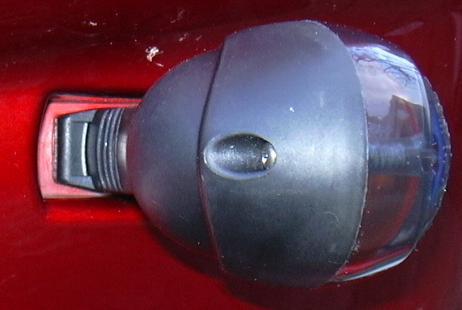

Found some indicators http://shop.wemoto.com/pictures.dyn?u=5836261qqq3657982 £11.75 each They have a flexable stem and just require the mounting hole to be increased in size and moved back slightly ( a round file did it in no time) The only problem is that they don't come with nuts, its a fine metric thread (1.25 I think) my local nut and bolt supplier couldn't help but my mate at a S*z*k* dealer found me some straight away. -
As for the indiators, if there is room you couldn't you put 2 LED's in,(one for each direction) ?
