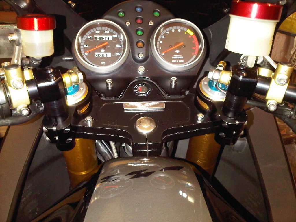

Just fitted these Apex bars from the US of A, nice quality and they have brought the bars closer and higher as needed, the tubes adjust in 8 positions for angle and they go up and down 4ins, the clamps can also be positioned anywhere around the fork tube either above the triple or below. At the same time I ordered a set of Convertibars that do the same thing, I think I am sticking with the Apex so if anyone wants to buy them in the UK give me a shout, there are no UK importers for either of these products. https://convertibars.3dcartstores.com/Moto-Guzzi_c_29.html http://www.apexmfg.com/products/category/view/11

Woodcraft riser clipons 54mm clamps and 64mm risers, fit the risers to the rear to bring the bars back, stock pipes do reach ok, drop the forks about 10mm as the new clamps are deeper than stock, this will only work on later bikes with the bars fitted on top of the triple. I also used the stock tubes and bar ends

Just ordered a set of Woodcraft clipons from the USA, half the price of UK supplier, you will need 54mm clamps and they come with a choice of rise from 0" to 3".You will want to fit them under the top triple and the clamps are in two pieces so no need to dismantle the forks. My plan is to fit them, with 1.5" rise, above the top triple and turn them around so that the bars are nearer, not sure if this is going to work yet so I will report back. Also you may find someone who wants to go the other way and swap the top triple, clamps and bars.
