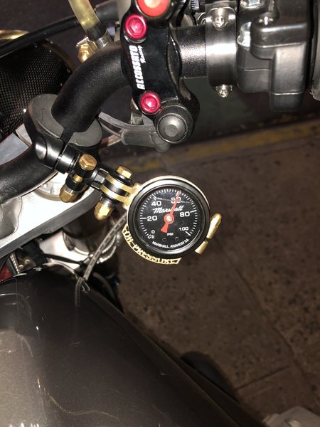

  3. Hello all. Today among other things I finally installed a handle bar mounted oil pressure gauge. I'd designed, 3D printed and installed the mounting hardware a while ago but didn't get around to plumbing it in until now. The pressure at idle is just above 60 psi. Oil was cold, didn't really let it warm up much further than this, was just testing it out. Does that seem correct? I'll take her out for a spin and see what it says when she's at running temp. I have fresh Amsoil 20w50 in there.

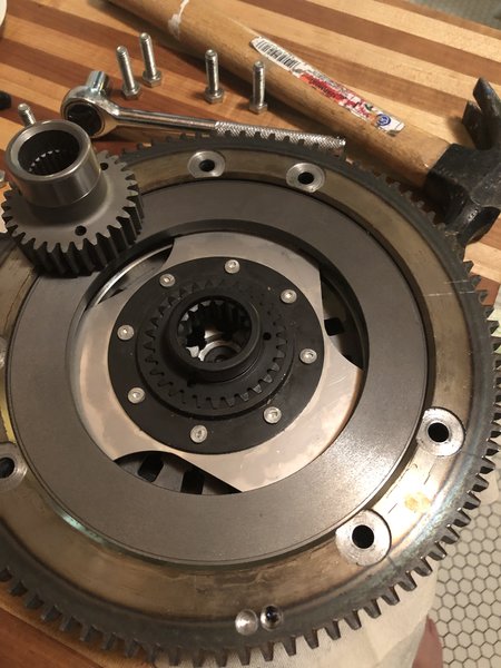

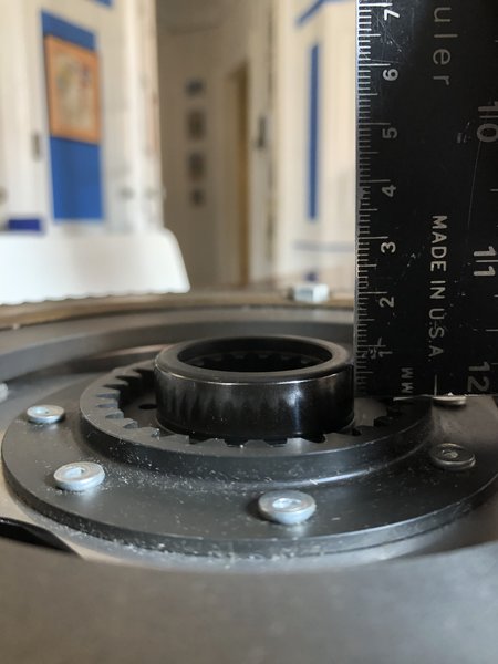

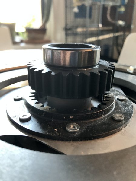

  8. Correct, RAM in South Carolina is not the same RAM, in Italy, that makes parts for Italian motorcycles. Pete, I have a new single plate from RAM, I can measure the thickness of the friction plate for you.
  9. Maybe Joe Caruso can be persuaded.

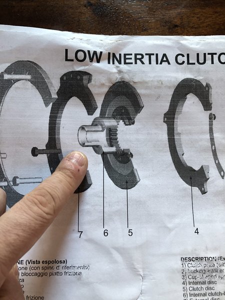

  10. Do you still have all the parts from your original single plate clutch, that was removed? Most importantly, do you still have the input hub? Looks like this: the one on the right is the one you hopefully still have (ignore the bigger one on the left): If you still have this hub, then you can use the "5 speed" single plate RAM clutch.
