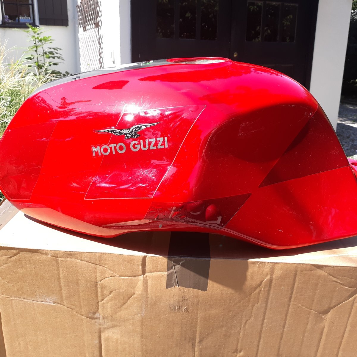

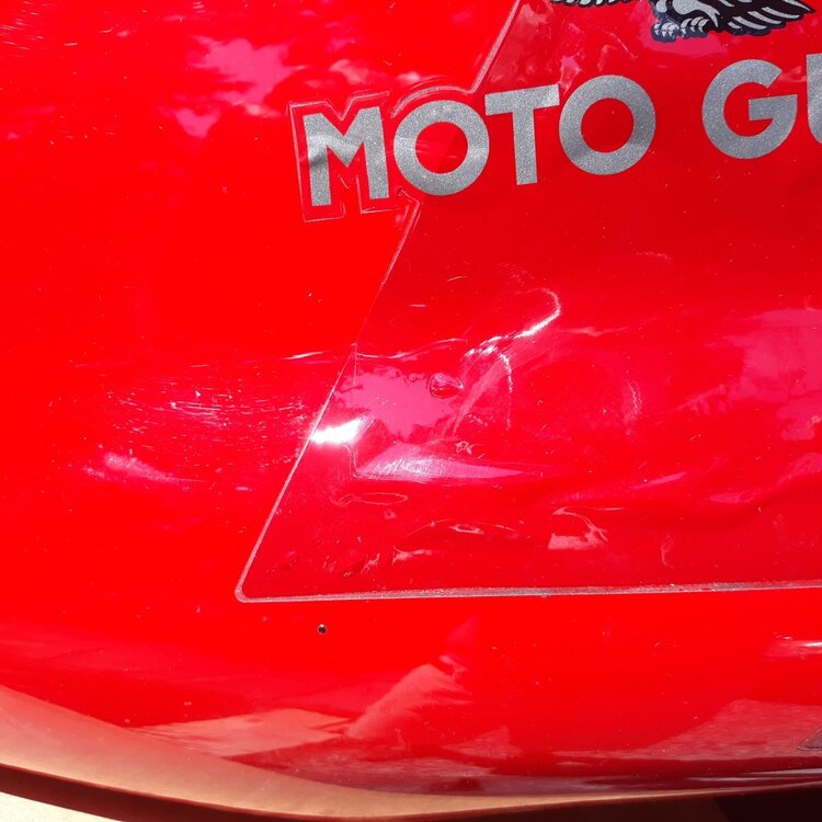

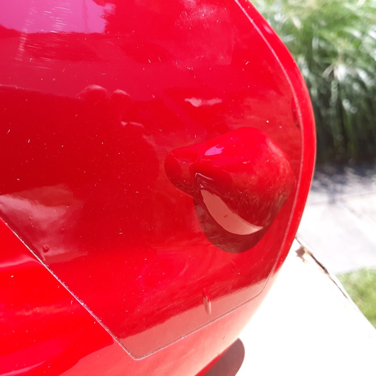

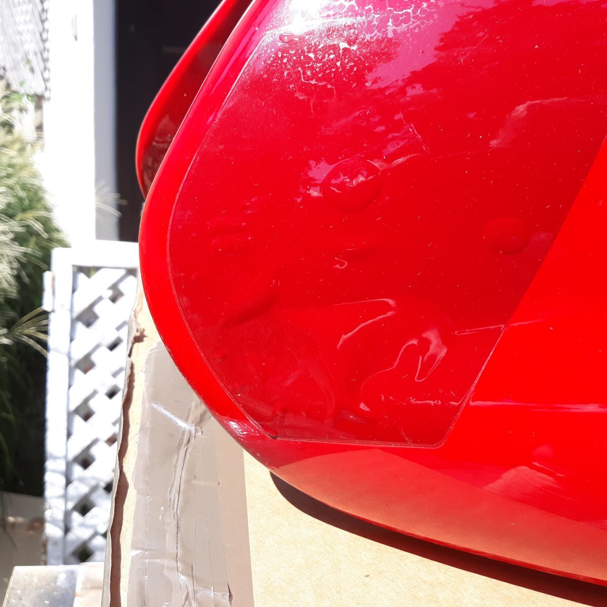

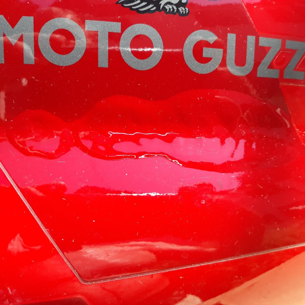

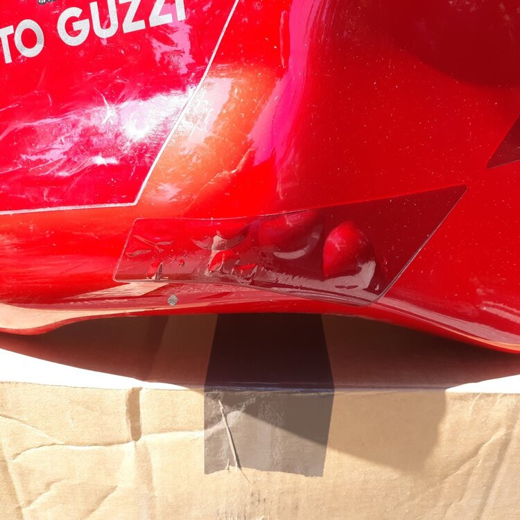

docc Posted September 3, 2023 Share Posted September 3, 2023 No cap? So, also the internal pump/filter assembly is not included? (Just to clarify . . .) Link to comment Share on other sites More sharing options...
p6x Posted September 3, 2023 Share Posted September 3, 2023 I am not certain to have understood the issue; is this for all the Rosso Corse tanks? Link to comment Share on other sites More sharing options...
docc Posted September 4, 2023 Share Posted September 4, 2023 1 hour ago, p6x said: I am not certain to have understood the issue; is this for all the Rosso Corse tanks? Yes. And Nero Corse decals, as well. Very unfortunate. Perhaps exacerbated by the byproducts of fuel containing ethanol, especially if stored for any length of time with degrading fuel in the tank. 1 Link to comment Share on other sites More sharing options...
drossell7 Posted September 4, 2023 Author Share Posted September 4, 2023 The tank does not include the cap or fuel pump/filter. 1 Link to comment Share on other sites More sharing options...
Lucky Phil Posted September 5, 2023 Share Posted September 5, 2023 18 hours ago, drossell7 said: The tank does not include the cap or fuel pump/filter. So the only way to deal with this is to have the tank bead blasted to remove the paint back to the plastic. Dry the tank out and a full repaint. So probably around 600 dollars US for all that. Phil Link to comment Share on other sites More sharing options...
