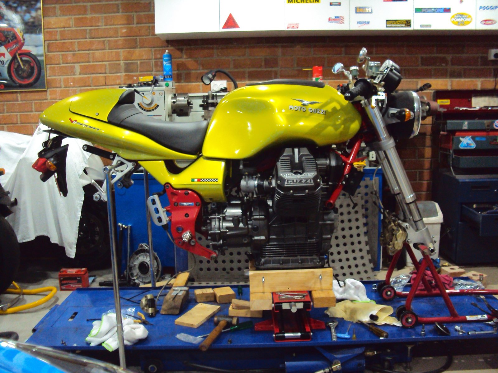

Lucky Phil Posted April 18 Posted April 18 (edited) 8 hours ago, Molly said: Thanks guys. I have that list printed out actually. Appreciated. I have a large selection of lifts, supports, stands, lumps of wood... Recently got hold of a lovely, German made impromptu centre stand / tool made for the BMW R-NineT. I think it can be adapted for the V11. By the way, the Michelin Road 6 tyres have really improved the handling. Anything would've I guess as the old ones were ancient. You can buy the exact same stand specifically for the V11. I have one myself. I also have a race stand for suspending from the front or rear of the frame. Phil Edited April 18 by Lucky Phil 3 1
audiomick Posted April 18 Posted April 18 41 minutes ago, Lucky Phil said: You can buy the exact same stand specifically for the V11. That would be this. I've got one too. Brilliant. https://shop.becker-technik.de/en/products/central-lifter-24 have a close look at the pictures there, and you'll probably see the way to adapt the one you have to the V11. 2 1

GuzziMoto Posted April 18 Posted April 18 The feeling of fresh tires is always nice. The worse the previous tires were the better the new tires feel. I have a few stands, mostly rear wheel stands that lift by the back of the swing arm. Once secured on that stand, getting the front up of the ground on a V11 can typically be done with a jack under the sump. But I make sure the bike is literally tied to the rear stand before doing that. I also have a couple stands that lift the front by the bottom of the forks. I also have a dolly I built with 4 casters and some wood that fits under the sump of a Guzzi. That holds it off the ground and allows me to wheel it around while both wheels are removed. And in extreme cases I have a hoist in the ceiling of my garage that can lift the entire bike off the ground if desired. But that I don't normally do. That is overkill. 1 1
