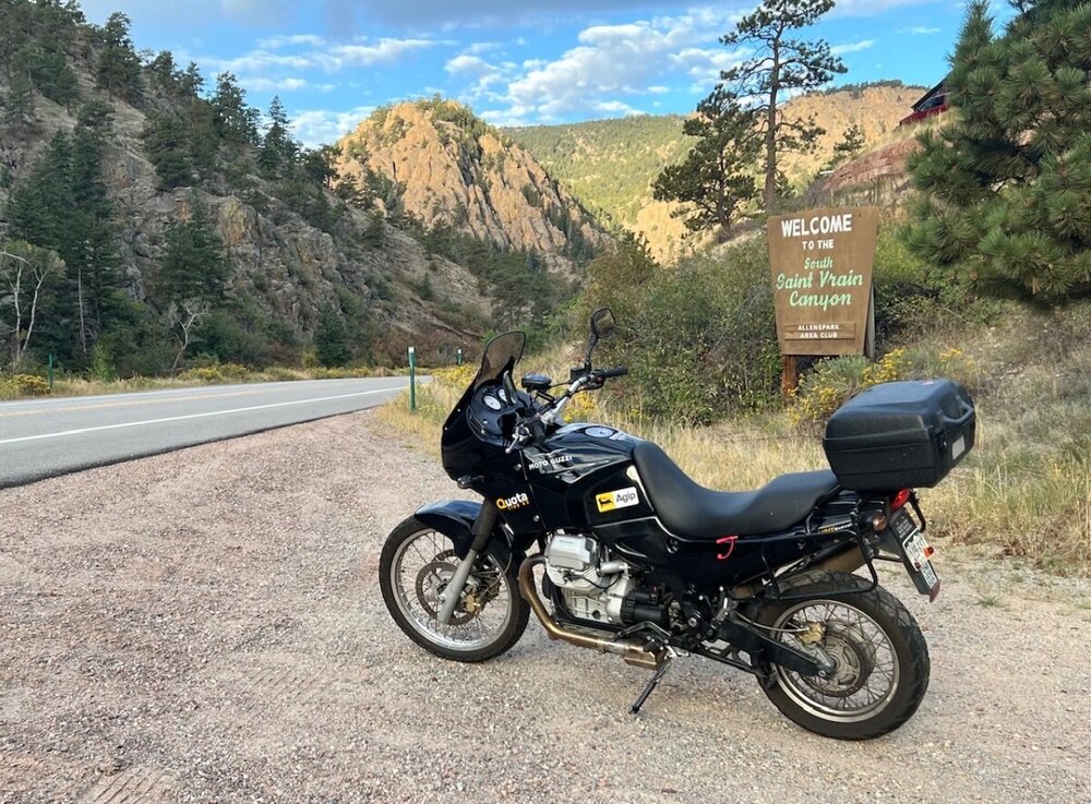

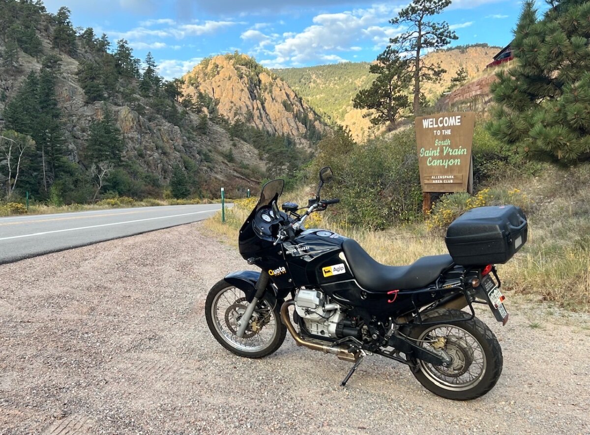

Sam P Posted Wednesday at 12:10 AM Author Posted Wednesday at 12:10 AM (edited) 42 minutes ago, audiomick said: I'm referring to the troubleshooting that I described in my post, but going through the Electrosport flow-chart looks like a good idea too. PS: regarding quoting or referring to posts: if you right-click on the "time-stamp" at the top of the relevant post, chose "copy link address" from the menu that appears, and paste that into your reply, you get this: I think that is what you are looking for in that regard. Well I do 99% of my www activity from an iPad - no right click available, lol! I will continue to troubleshoot and report back. Crap, glad I have my Quota to ride while the much more fun V11S is under repair. It's a beautiful time to ride here in Colorado. Edited Wednesday at 12:16 AM by Sam P Add Quota pic 2 2
