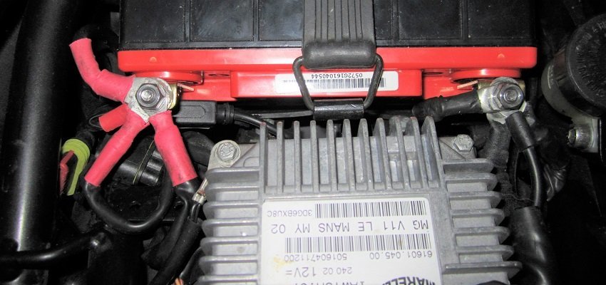

Here is a pic of my 2004 Naked that is bone stock, save the more user friendly battery terminal adapters I added, showing 4 and 4 leads off the terminals, FWIW.  Don't ask me what they all are!  :huh2:
4 + 4= #1 Main cables, #2 Fuel/Ignition harness, #3 Lighting/starting/charging harness (yes, two completely separate harnesses from the factory!), #4: something added for power access (charging or accessory power).
#5? Likely a regulator ground (second ring terminal seen on the regulator case) or a second accessory (like a GPS).
That ends up being a lot of ring terminals on the battery and a formula for corrosion and loosening. The reason some of us added junction blocks (which can also corrode and loosen!) . . .
