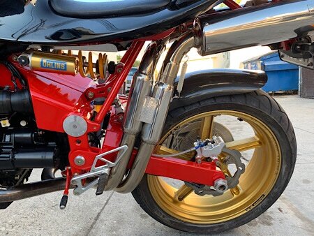

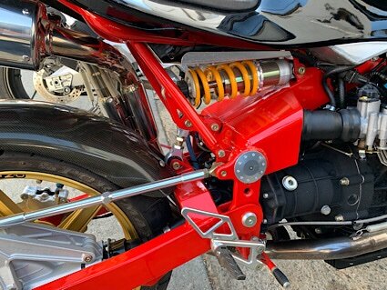

I recently did a suspension upgrade by adding Racetech fork springs and an Ohlins rear shock that came off of a Scura. Big improvement in the ride of the ‘01 Greenie with these on it. The Ohlins feels great. Also did a tire change before this, going from a 170 rear to a Road 5 160, and I really like the overall set-up of the bike. One thing to mention in case people would like to do the shock swap for a Scura Ohlins, is the Ohlins remote reservoir is a bit longer than the OEM unit, and will mount butt-up to the pork chop to allow sufficient clearance for the throttle body linkage. At least that was how it went for me. I am very happy with the swap, and I even like the color clash of the gold shock reservoir and the red and green of the bike.

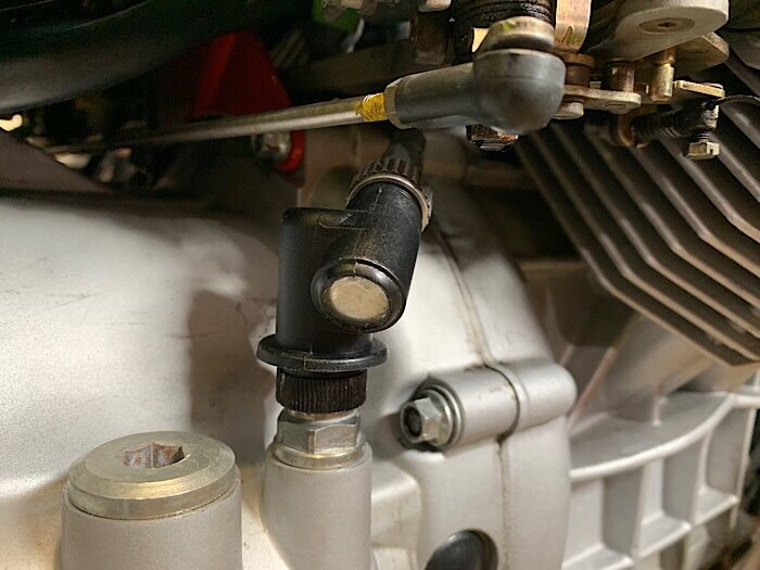

While I sort out the details for the Speedhut set up I went ahead and ordered a replacement angle drive from this eBay vendor. It was inexpensive compared to the few others that I had seen, fast shipping between San Jose and L.A., and it’s the only one that I saw that had the screw down collar and flange built into it. The Ducati drive that I found that supposedly works is just the plastic elbow and interior plastic worm gear, and the one on MG Cycle looks like it has a screw down plate. This one with the flange and collar is like the one that was originally on my bike. Anyway, I epoxy coated the disk bit, installed, and the speedo is back, albeit still sans the trip meter. Thanks very much for the link to this part. He looks like a good parts source. Cheers -

@Rolf Halvorsen, thank you for this, and for the links and info on a simpler and better cable alternative to the problematic angle drive. Why do you say to not remove the male threaded part that comes out of the gearbox? If I am not going to use the speedometer cable drive, why not get the cleanest look for the gearbox by removing the part and plugging the hole with a simple filler plug? What’s the concern? -

docc, thank you for that important information! I had looked at that thread but must have missed that post. When I pull the protruding drive component—the threaded male piece—from the gearbox will the two thrust washers come out with it, or will I need to somehow fish them out of the gearbox hole? Are they stacked upon each other or in different places? i don’t know why I can’t find a clear diagram of these pieces in the on-line parts catalogs. The “Dash” page shows the angle drive and the male threaded piece that comes out of the gearbox case, called an “odometer gear”, but no thrust washers. And the “Transmisson cage” page shows the view from the left side and even omits the oil filler plug. What am I missing? I am using the files on the AF1Racing site. Thanks, too, for posting the link for the cap to plug the hole. That looks like a clean option to match the oil filler plug. -

Hi folks. I would like to ditch the speedo drive and need a little advice on the best way to seal up the transmission case where drive was attached. Soon after getting my ‘01 V11 back on the road my speedo stopped working. When attached to a drill chuck the cable spins the speedo’s needle , so the problem must be the drive at the tranny. Anyway, I know that the plastic angled part is prone to failure, and replacements are expensive and hard to find (I think there is a Ducati part still available that is the same, but it’s like $70 +). Also my trip meter has never worked on my speedo, a stock white face Veglia. It would be really nice to have a trip meter! So, rather than sending the speedo off for repair, and dicking around with repairing/replacing the drive (which seems to be an endangered species), I am thinking of going the Speedhut GPS route. After removing the angled drive and the shaft piece, what I have left in place on the transmission case is the piece with the male thread that the angled drive and shaft attach to. I have not been able to find any parts diagrams that show this piece, and I am not really sure if it’s part of the drive as a whole, or what it is doing with the transmission. So, if I am going to eliminate the speedo drive from the top of the transmission case and go with a GPS speedo, do I simply cap off the top of the male threaded bit, or should I remove this piece from the transmission case? And if so, what can I expect to be taking out, are there any other pieces that need to come out? And lastly, what is the best thing to use to plug up the hole? I have seen many threads here on replacing the speedo, but have yet to find specific info on plugging up the case where the drive once was. Perhaps it’s so obvious that it goes without saying, and I am just a dullard with trepidations when it comes to doing anything that could result in drive bits being left behind and getting mixed up inside of the transmission. Thank you for any guidance and advice on this!
