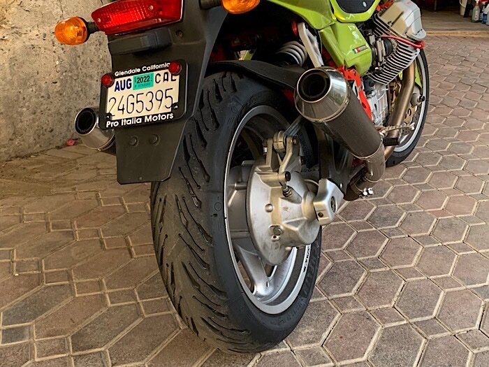

Put on a set of Michelin Road 5 tires yesterday. Only 100 miles on them so far, moderate riding, but they feel great. Lively and stable, more so than the Shinko Verge tires that were on before. The Shinkos were on the bike when I got it about three years ago, looked pretty fresh, and they are not bad, certainly pretty good mileage with them. I found a piece of metal, like an oblong nail head, stuck into the rear Shinko, and while it was not leaking air (it turned out that what ever the metal was it did not go all the way through the tire), I figured that was a good sign to do what I’ve been wanting to do for a while and try a higher grade of performance tire. I was also interested in the Metzler Sportec M9 RR, but I couldn’t find the front tire. I have been intertested in the Road 5’s for a while, and am pretty happy. The front is a 120/70 and the rear is a 160/60. The bike had a 170/60 rear on before, and the 160/60 profile no doubt is part of the lively feel. The bike feels lighter! I guess I am changing the overall geometry, too, but I’m not sure exactly how. And fwiw, these tires are made in Spain. I will post periodic updates on how these tires perform for the V11. I also installed a new Odyssey PC545 battery (Hiya, docc!) and a new voltage regulator/rectifier from ElectroSport here in Southern California (made in China, but whatcha gonna do!). The old battery had a wobbly looking case from getting overheated, the bike was eating the 30A battery fuses like they were Lays potato chips, and my battery light would come on around 5k rpm. Now she’s running all of that cool as a cucumber, but I think the headligh bulb is toast. That will be next, this weekend, I just need to get home before dark until then! I love this bike! Cheers!
