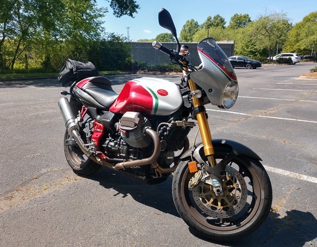

    Decided it was the day to play with maps and tuning. Did the Decent Tune Up route a few weeks ago and valves to 0.007/0.009", idle bypass full closed. Coppa with Ti mufflers and front crossover. I've not been able to match the map up on it with anything out there, ran decently except for the occasional 3k blip and stubborn cold start. First up was Meinolf's 2017.08.31_#93_6. Cured the cold start issue, fired up right off. Set idle to 1100 rpm and went for a ride. Huge improvement at 4-5000 rpm up. Only problem was 3k rpm cruising, stumbling and missing like crazy. Roll on a little and it would go away. Next was V11 IAW 15M ECU Titanium 2 from the file uploads. I'm assuming this is the stock bin as described, if anyone can compare it to a stock Ti bin to confirm I'd appreciate it. Cold start was good, without changing the idle screw the idle was now up to 1400 rpm from 1100, thought that was interesting. 3-4000 rpm 6th gear roll on was a little better than Meinolf's, 4-5000 rpm was almost as good. 3k cruising and it never missed a lick. I'm going to stick with the Ti bin for the time being, very happy with it. Two questions I'd like answers for: 1. What's the difference between the two that accounts for the difference in idle speeds without changing the idle set screw? 2. Why did Meinolf's stumble so much at 3k but the Ti didn't? This really surprised me since I'd read nothing but good about it. Maybe the valve settings?
