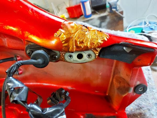

Any thoughts on how I'm going to repair the paint finish on my RM tank. Its bubbled next to the fuel tap. Only about 3-4 mm is visible when the tank if fitted I had a fuel leak from where the fuel tap connects to the tank. I've fixed that by replacing the o-ring (they are actually oval-rings) from local supplier as Guzzi agents in New Zealand had none. Make sure you get Viton ones which are impervious to petrol
