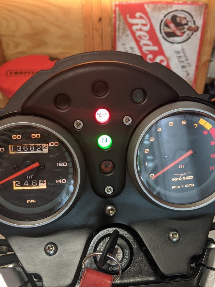

  5. New oil pressure switch arrived and installed, behold - red light with key on, and it goes out when engine is started. Thank God for little miracles (and knowledgeable friends on this forum!).

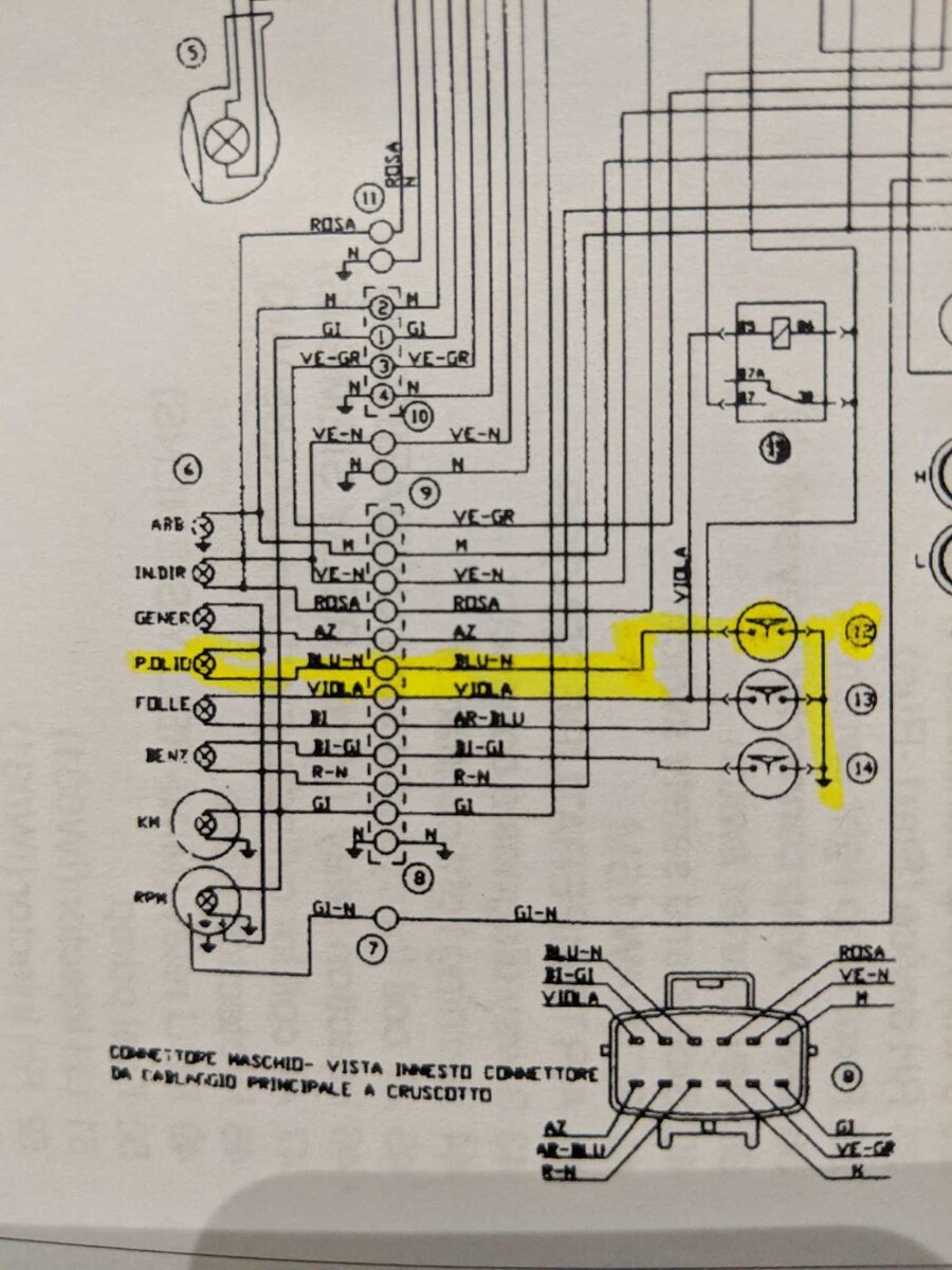

  11. Checking that in a minute Docc, meanwhile, here is that circuit in the wiring diagram. #12 being the oil pressure switch:

  20. ...as seen here:
  21. Turns out the blue ground wire is not grounding. When I touch the bulb contact wires to the red wire and my grounded test light probe, the bulb illuminates. Now what?!
