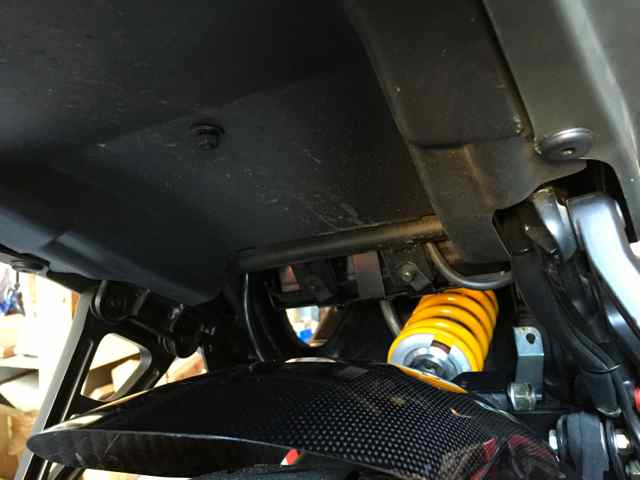

  17. I was motivated to do this for cosmetic reasons. The silver fuel door just seemed wrong on the Scura - and I could not find a black billet replacement. But then I noticed that the paint was peeling pretty badly and got to wondering if those big flakes of paint would be bad for the petcock or fuel pump on the way to the filter. Couldn't find any other info on this, so I took these pics to give myself a chance at putting it back together after powder-coating, where it currently is. The "after" pictures will have to wait a while... To take it apart: 1) Remove 6 outside bolts and one inside bolt. Maybe cover the hole so you don't drop a tool or part in the tank. There is a large base and some gaskets to set aside - nothing tricky (tricks come later.) 2) Take off the latch and seal (red and black bit), revealing more little parts, including 4 tiny springs and a thin plate. (Note that springs and other tiny parts do not roll off towels). 3) Pry up the dark metal piece and remove the rubber gasket beneath it. Here's the part that was tricky to me - getting the lock out. 4) Pry out the O-ring from the bottom and get ready to catch two thin metal washers. Then pry out the top rubber fitting (which has a couple feety-hook-things - a little lube will help ease it out and be sure you don't tear it.) edit: do not remove the top rubber fitting as shown in the photo. It should come out (and go back in) with the lock cylinder. 5) Compress the little retaining tab into the lock cylinder and remove it from the cap. One pic shows where to access it, the other shows it removed. I left three parts assembled for powder coating: the base-ring, the fuel-door, and the flippy-lock-cover-tab (which probably has a real name). There are some retaining pins, and spring-actuated balls holding these three parts together, but I decided not to take them apart.
