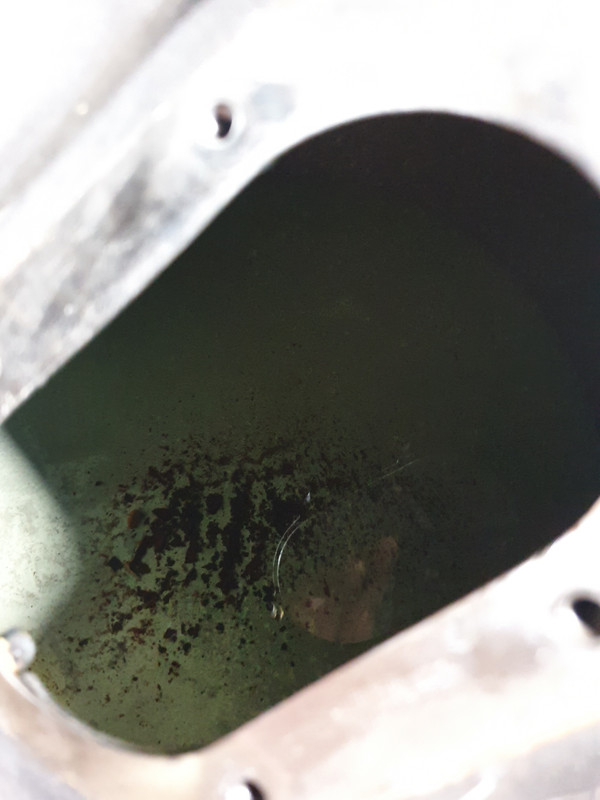

Cali1100i Posted July 31, 2020 Posted July 31, 2020 On 7/29/2020 at 12:55 AM, 80CX100 said: Cali1100i,    The CalVins were one of the bikes with the dissolving fuel lines inside the tank; usually that issue should have been addressed by now, but if it's been been neglected and just parked, it could be the source of fuel delivery grief.    Make your mechanic aware that it may be an issue at play.    It sounds like there may be a bit of corrosion, a good methodical clean up of wiring connections, grounds etc with deoxit and a dab of vaseline should help things in the long term.    Good luck with it    Kelly Thanks, Kelly. Went on a 500 mile round-trip on it, shortly after getting it. Was about 70 miles out when I found it struggling to maintain 65 mph. Kept going. Last 100 miles of the outward journey struggled to maintain 40 mph on a motorway, and limped to my destination. Exhausted. Seven hours to cover 250 miles. Next day, tank off, fuel pump and filter out. Scavenged a drill bit and reamed it, spigot to spigot, to allow fuel to flow through it. Filter completely blocked with rust particles. Strained the remaining fuel through a dish-cloth into a cut down Coke bottle (because I had to, no spare fuel). Cleaned out the tank as best I could. Strained fuel back in. Performed like a sports-bike on the way home. I believed I aged 5 years on that return trip, thinking of rust particles getting into the injectors. Luckily I had some tools with me, due to past experiences with the Cali 1100i. It was an interesting weekend. 1 1
80CX100 Posted August 1, 2020 Posted August 1, 2020 5 hours ago, Cali1100i said: Thanks, Kelly. Went on a 500 mile round-trip on it, shortly after getting it. Was about 70 miles out when I found it struggling to maintain 65 mph. Kept going. Last 100 miles of the outward journey struggled to maintain 40 mph on a motorway, and limped to my destination. Exhausted. Seven hours to cover 250 miles. Next day, tank off, fuel pump and filter out. Scavenged a drill bit and reamed it, spigot to spigot, to allow fuel to flow through it. Filter completely blocked with rust particles. Strained the remaining fuel through a dish-cloth into a cut down Coke bottle (because I had to, no spare fuel). Cleaned out the tank as best I could. Strained fuel back in. Performed like a sports-bike on the way home. I believed I aged 5 years on that return trip, thinking of rust particles getting into the injectors. Luckily I had some tools with me, due to past experiences with the Cali 1100i. It was an interesting weekend. Better you than me, that sounds ugly,,,  ;~) lol. Tbh, you've been further into that tank than I have; my bike already had the fuel line fix done by the PO when I got the bike. I've heard it's a bear of a job on a good day in your garage with proper tools, you did well to mcgyver your way home. All that rust sounds bad, if the inside of the tank is rusty I've heard of guys putting something like screws or nuts and bolts in the tank, putting it in an old sleeping bag and stuffing it in the dryer with pillows all around it, tumbling it carefully and keep repositioning it. How did the fuel lines from filter/pump look in your hands, soft punky/cracked or in good shape? The original defective ones should be marked SAEJ30R9 or 30R7. The updated good lines resistant to being immersed in fuel should be marked SAE 30R10, I think suitable hose should be available locally. Good luck  Â
Cali1100i Posted August 1, 2020 Posted August 1, 2020 Very little Ethanol in the petrol here, which I hear is the source of most of the fuel-line problems world-wide. The in-tank fuel-line in mine was a black concertina type heavy "plastic" and was factory fitted, judging by the metal clips used to secure it to the pump. And yes, it was a bitch of a job to do road-side. I had heard that the plastic connector from under the tank was a devil to disconnect, easy to break, and that there was a "knack" to disconnect it. Get it wrong and almost impossible to bodge a road-side repair. More art than science. It took hours. And it was only an "educated guess" that the filter was the problem. I was a happy camper when it ran. If you ever have to remove the pump/filter assembly, keep the cable-tie that secures the filter to the pump-body really loose. Work the assembly into the tank slowly and methodically and try to think in 3D. Once in, tighten the cable tie from outside the tank before bolting the mounting plate into position. Not a job I want to repeat road-side in a hurry. My mechanic, who is also a biker, advised putting an egg-cup full of motor oil into the tank ever so often, when its full of fuel, to inhibit rusting inside the tank.
Tinus89 Posted August 3, 2020 Posted August 3, 2020 Here is a picture of a well-maintained, indoors-kept CaliVin tank inside.... 1
