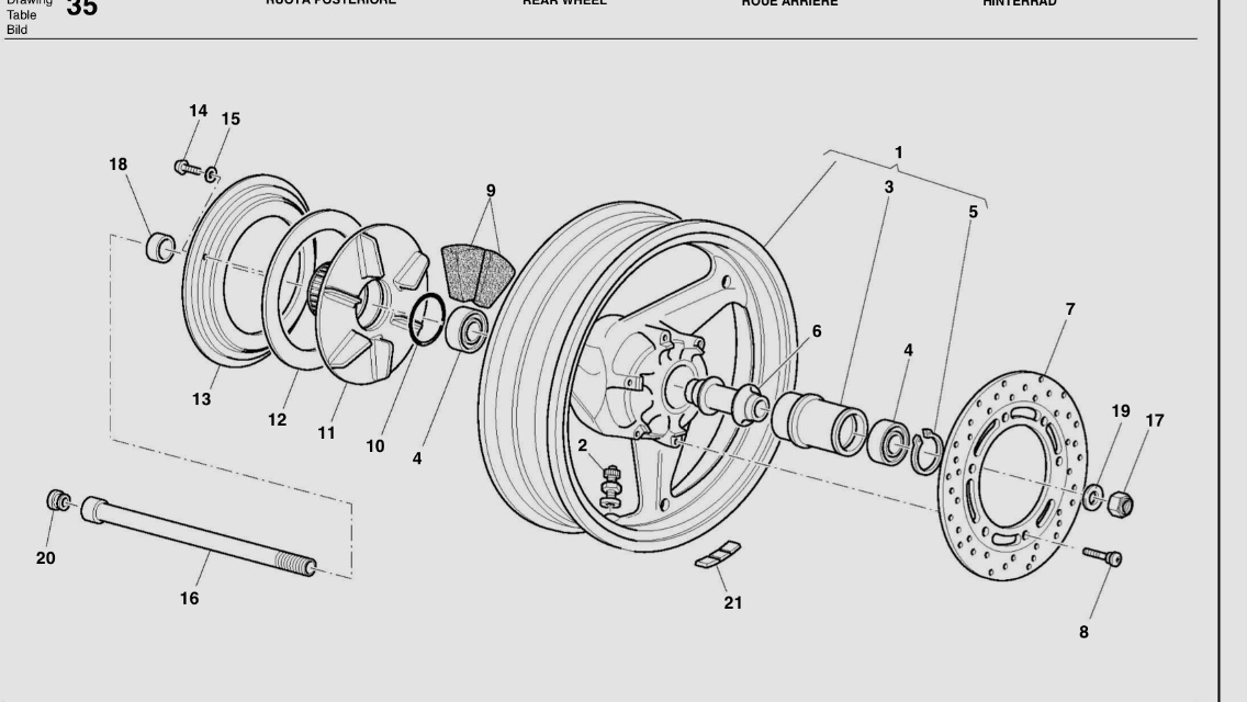

Planning on doing my rear wheel bearings tonight, just wanted to double check that I wasn't missing any critical new parts before I take everything apart. I have the bearings of course, I also have a replacement for parts 10 and 5 in the exploded diagram below. I didn't see anything else like seals etc, so just wanted to check with you guys to make sure I wasn't missing something... Thanks!

No,you have it. Just find the notch in the spacer and tap (or bang) out the old then press in the new, freezing the bearings does help.

Yea both the same size and type. Check the bearing spacer length.

Hi Gio,
The rear wheel bearings are both 6204-2RSH  47mm dia x 14 wide x 20 bore
The front wheel takes two different bearings for the pre-'03 Marzocchi forked bikes.
6205-2RS  52 dia x 15 wide x 25 bore
6304-2RS 52 dia x 15 wide x 20 bore
Hope this helps,
Tom
