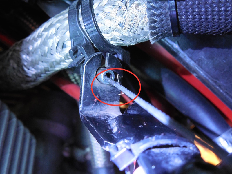

docc Posted June 27, 2015 Share Posted June 27, 2015 Doing some pre-ride prep I can feel a broken strand on the throttle cable; not separated yet. No way I can have a replacement in time to leave out in 36 hours. So . . . . can a cable like be soldered lightly while the strand is still gathered up? Or just leave it alone for the next 600 miles/ 1.000 km? Link to comment Share on other sites More sharing options...
Scud Posted June 27, 2015 Share Posted June 27, 2015 I just replaced the throttle cable on my LeMans yesterday. It had a rough spot from a broken strand - and it was bent at the bracket near the throttle body, because it had been under tension from high bars. I could occasionally feel the rough spot when twisting or releasing the throttle. I put well over 1,000 miles on it after I noticed it (not sure how long it was like that). It was still moving freely - never got stuck on the rough spot. To your question - no idea about the soldering, but if it's similar to my experience, I think you will be fine as-is for a few hundred miles. Is there a dealer along the (hopefully winding) route you plan to take? Maybe you can grab a spare on the way. Link to comment Share on other sites More sharing options...

Craig Posted June 27, 2015 Share Posted June 27, 2015 DO NOT solder the cable. You will end up move significant bending stress to the edges of the region you soldered. That almost guarantees rapid fatigue failure. Link to comment Share on other sites More sharing options...
docc Posted June 30, 2015 Author Share Posted June 30, 2015 Get yourself a cable repair kit - if the cable breaks in transit you can thread a new cable down the old sheath, and screw whatever ends you need on. I've carried them on my dirt bikes for about 20 years and fixed heaps of other peoples clutches / throttles - they're a guarantee your own cable will never snap That's a great idea to carry. I just bought one to stash under-seat. http://www.amazon.com/Gear-Gremlin-GG150-Cable-Repair/dp/B008U9HO0C/ref=pd_sim_263_2?ie=UTF8&refRID=06330BBBHS3NNTWX18GT Winding route for certain, but "dealers" where we're going are more likely purveying meth and moonshine . . . Docc - You are like a one-man tourism and visitor's bureau... always pointing out the unique charms and recreational opportunities available in "Middle Tennessee." Actually, we were bent on "points beyond . . ." @Craig - Thanks for that good advice; makes perfect sense. The cable rode 700+ miles, no problem. I'll get one on order. This one lasted 33,000 miles and would likely go much further if I didn't know about the tiny fault in the single strand. 1 Link to comment Share on other sites More sharing options...

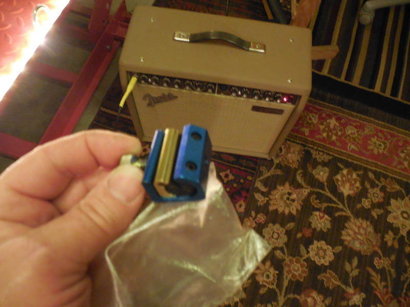

gstallons Posted July 1, 2015 Share Posted July 1, 2015 If you can find a very old motorcycle shop or motorcycle mechanic ....they can replace the inner cable as long as the outer cable is good. Since the throttle bodies have less tension than carb models , the cable will last longer. I assume you are old enough to have a cable lube set-up ? Link to comment Share on other sites More sharing options...
docc Posted July 1, 2015 Author Share Posted July 1, 2015 I assume you are old enough to have a cable lube set-up ? Something like this gizmo? Perhaps I should be applying it more often. Maybe every oil change or at least every gear oil change? What's the preferred cable lube these days? Link to comment Share on other sites More sharing options...

gstallons Posted July 1, 2015 Share Posted July 1, 2015 I use Tri-Flo spray lube. pricey. But if you buy & use it once you will be hooked on it ! Link to comment Share on other sites More sharing options...

docc Posted September 15, 2015 Author Share Posted September 15, 2015 Almost 2,000 miles on and the cable is showing definite signs of unraveling. Before I head to Barber Vintage Festival in a few weeks, I suppose I'm destined for the Tank Off Maintenance Checklist! (and the new throttle cable . . .) Link to comment Share on other sites More sharing options...
