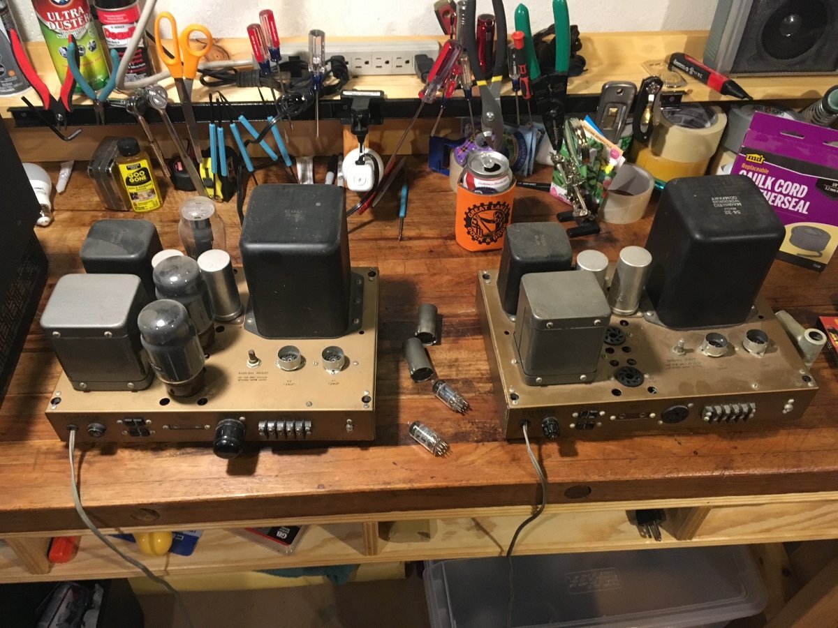

Here is a photo of the underside of my rehabilitated 30-A mono amplifier after recapping, etc
This and the FM-50 mono FM tuner will power a 1950s cabinet for which I've built custom crossovers, etc
Some vintage NOS GE EL84 tubes provide the amplification, with vintage 12ax7 and rectifier tubes.

For sure ! While I know what "caps" (capacitors) are, how to do anything with them is beyond me. I noticed my amp *sizzling* a little from time to time. Is that something with the caps or was that this rectifier going bad?
A couple more questions on the rectifier, if you please:
  1)  If I press it really hard or rock it toward one side it come on. It looks to have a "retainer,  but the tube won't stay plugged in. Is this just a connectivity problem with the chassis?
  2) I've heard that these amps should not just be left on, but I'm guilty of that more lately without using the "standby."  Has this contributed to my rectifier problem?

1)  That does sound like you have a connectivity problem with the chassis, not the tube.  It is possible that you have a broken/cracked pin on the tube, but I suspect you have a loose socket or other intermittent electrical connection.  It's likely that the socket just needs to be replaced.  To be honest, you might consider taking it to someone.  I bet they can diagnose and replace a socket for a lot less than your time & worry are worth in this case.  As far as how the tube is secured, I don't know about this amplifier but some tube amplifiers with inverted (hanging) tubes do have a little metal hook, spring or ring to secure the tube from vibrating out.
2)  Actually it's good to leave most amplifiers, whether tube or SS, in an "idle" state so that some electrical current is trickling through the power supply; see the comments about electrolytic capacitors.  Some higher end SS equipment do this by default and will often indicate it with a "standby" LED, and many tube amplifiers will have a "standby" switch that keeps the tubes and power supply warmed up and ready to go.  But if you play your amplifier regularly, every month or so, I don't know that it is helpful to keep it in a standby mode and you are exercising it enough to keep it healthy.
Keep in mind that with most tube amplifiers it can be destructive to the output transformers to run the amplifier without a speaker connected.  For an integrated/combo guitar amp with a speaker built-in, this isn't an issue.  For standalone heads it can be.   The amplifier won't "fry" instantly, so I don't mean to frighten anyone, but it's best just to avoid it entirely by keeping a circuit closed on the output side by having a speaker attached and giving the induced current somewhere to go.
