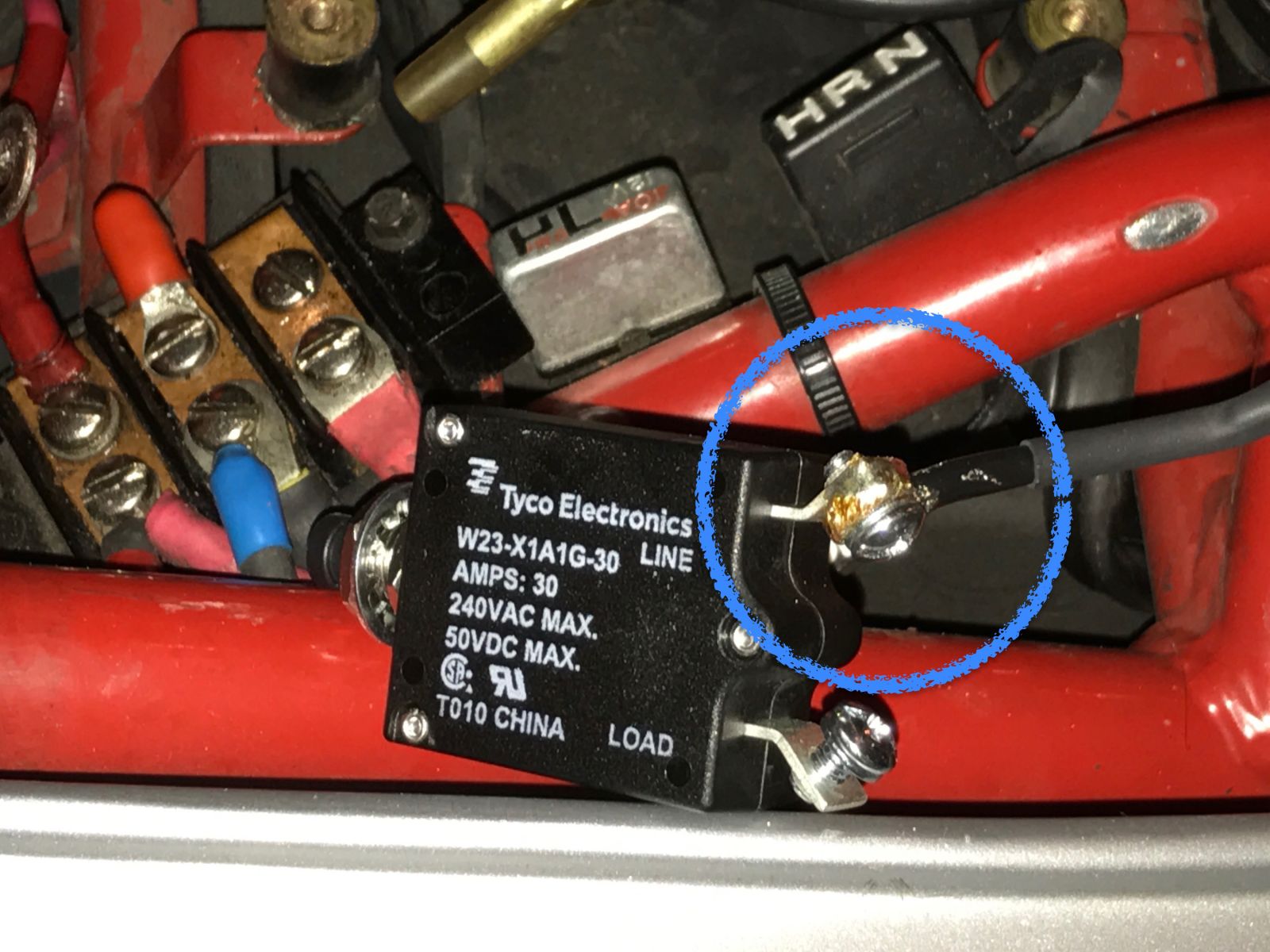

docc Posted November 15, 2016 Author Report Share Posted November 15, 2016 I have the 30 amp circuit breaker in hand. Once "popped" it is 3 inches / 7,5 cm long. Not sure how I'm going to mount it so it has clearance to "pop" and the terminals will be clear of any ground path. The terminals are labelled "LINE" and "LOAD." My understanding is that this sits between the regulator and the battery. Is the battery the "LOAD?" (It is definitely the regulator side that gets hot.) Link to comment Share on other sites More sharing options...
Kiwi_Roy Posted November 15, 2016 Report Share Posted November 15, 2016 That big, It might be able to double as a kick stand. Line is usually the supply which is the alternator in this case but I doubt it matters at all. Link to comment Share on other sites More sharing options...

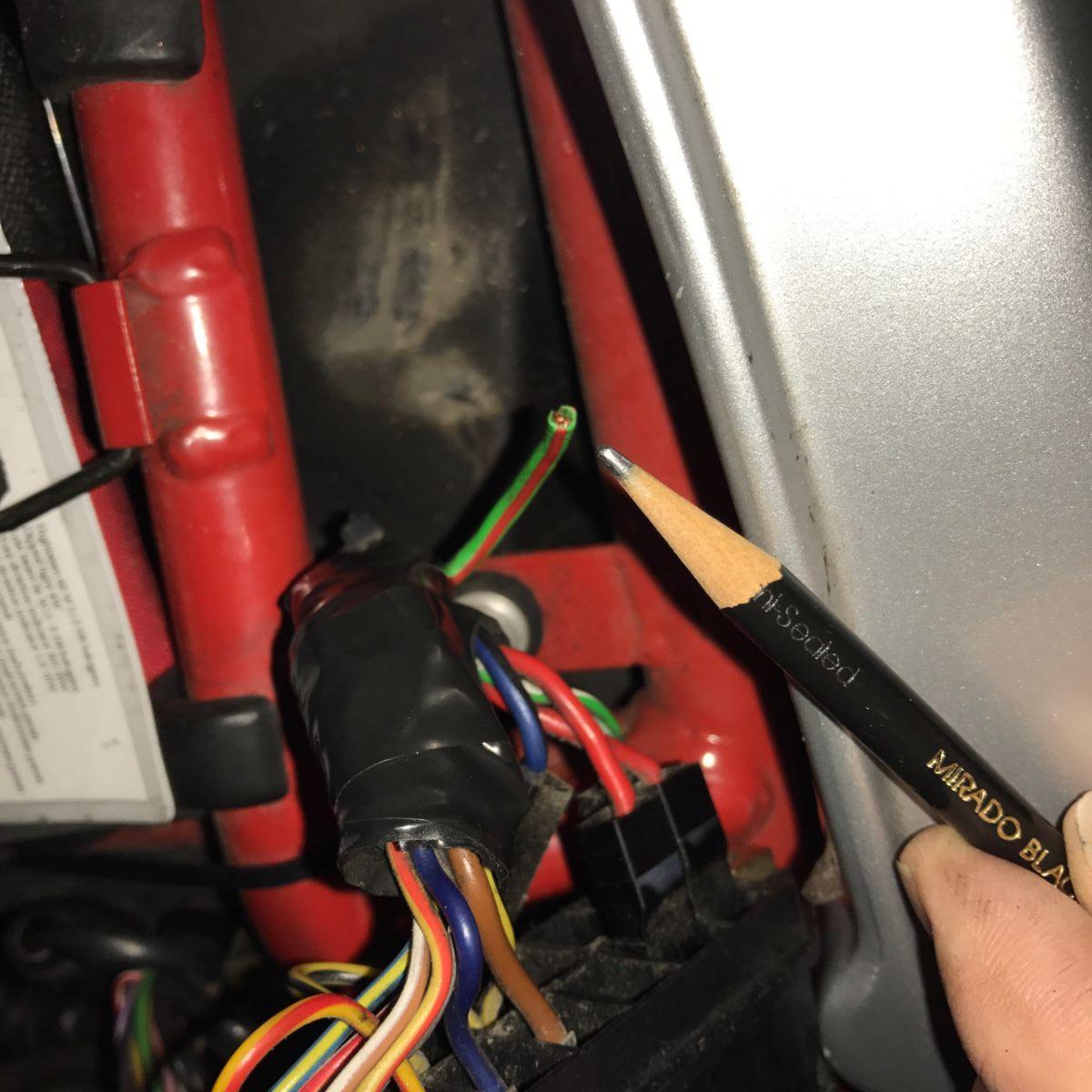

docc Posted November 15, 2016 Author Report Share Posted November 15, 2016 So, this little green/red wire carries 30 amps from the alternator all the way to the battery? Seems dubiously undersized . . . perhaps it is 14 gauge just going by the notch on my strippers. Link to comment Share on other sites More sharing options...

docc Posted November 15, 2016 Author Report Share Posted November 15, 2016 Having grown terribly tired of this connection melting and turning to charcoal, without ever opening the fuse, I am determined to get a solid connection: tinned 12 gauge wire soldered to the circuit breaker. 1 Link to comment Share on other sites More sharing options...

Chuck Posted November 15, 2016 Report Share Posted November 15, 2016 For what it's worth.. the FAA doesn't allow soldered terminals. The solder wicks up the wire and makes it brittle. It'll eventually break right at the terminal with vibration. Just the same.. I don't blame you for doing that. I'd be upset, too.. Link to comment Share on other sites More sharing options...
