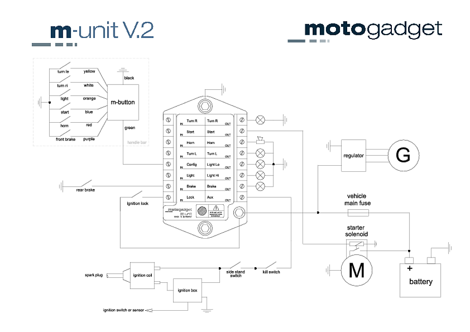

sp838 Posted November 22, 2016 Report Share Posted November 22, 2016 I had grand ambitions of rewiring mine with a Motogadget M-unit this winter. Starting to get cold feet though. This and your other mods are good solutions. 1 Link to comment Share on other sites More sharing options...
Kiwi_Roy Posted November 22, 2016 Report Share Posted November 22, 2016 I had grand ambitions of rewiring mine with a Motogadget M-unit this winter. Starting to get cold feet though. This and your other mods are good solutions. I think you will have a hard time finding a better fuse block than the OEM one, granted the 30 Amp is a problem although I still have mine. I doubt the M-unit will handle the charging any better than the OEM 1 1 Link to comment Share on other sites More sharing options...
sp838 Posted November 22, 2016 Report Share Posted November 22, 2016 The M-Unit doesn't handle charging. It handles power routing and switching, and consolidates the functions of the fuse block and all the relays into one very compact unit. It is solid state, with no fuses or moving switches. It has a lot of really really cool functionality built in (blinking the brake light, auto canceling turn signals, ts can be used as position lights, alarm system...) The only thing stopping me is the fact that our bikes are fuel injected which means loads of sensors etc, and that makes me nervous. I think I've found a solution, but it would still be a lot of work, and being newly married, I don't have the luxury of being able to sit in the garage all night, every night, anymore. I hear that changes over the years, haha Edited to add: you still need to have a fuse for your R/R when using an M-Unit. You get to ditch all the other ones (and relays) though. Link to comment Share on other sites More sharing options...
docc Posted November 22, 2016 Author Report Share Posted November 22, 2016 The M-Unit doesn't handle charging. It handles power routing and switching, and consolidates the functions of the fuse block and all the relays into one very compact unit. It is solid state, with no fuses or moving switches. It has a lot of really really cool functionality built in (blinking the brake light, auto canceling turn signals, ts can be used as position lights, alarm system...) The only thing stopping me is the fact that our bikes are fuel injected which means loads of sensors etc, and that makes me nervous. I think I've found a solution, but it would still be a lot of work, and being newly married, I don't have the luxury of being able to sit in the garage all night, every night, anymore. I hear that changes over the years, haha Edited to add: you still need to have a fuse for your R/R when using an M-Unit. You get to ditch all the other ones (and relays) though. The purpose of the 30 amp Fuse 3 is to route the charging current to the battery, which is (I believe) what Kiwi_Roy means by "handling the charging." So, the M-Unit doesn't house this circuit and you would need external 30 amp circuit protection for the charging ("Fuse 3") anyway? Link to comment Share on other sites More sharing options...
sp838 Posted November 22, 2016 Report Share Posted November 22, 2016 "So, the M-Unit doesn't house this circuit and you would need external 30 amp circuit protection for the charging ("Fuse 3") anyway?" Correct. The R/R line to the battery does not pass through the M-Unit, and still requires a fuse. Link to comment Share on other sites More sharing options...
Scud Posted November 22, 2016 Report Share Posted November 22, 2016 ...and being newly married, I don't have the luxury of being able to sit in the garage all night, every night, anymore. I hear that changes over the years, haha Congratulations. My experience is that as soon as my wife got addicted to an evening TV show, I got to use that time productively (aka sit in the garage all night). Wiring? I got nuthin' 1 Link to comment Share on other sites More sharing options...
Kiwi_Roy Posted November 22, 2016 Report Share Posted November 22, 2016 SP838 Oh I see what you are thinking, a complete rewire One thing to check out, what is the Start Out rated at, it needs to be good for about 50 Amps inrush, the solenoid pulls that for about 1/10th of a second. I think you should have a dedicated 30 or 40 Amp fuse between regulator and the battery it just has to melt before the wire catches fire A wire from the Aux output to power up the Ducati Energia regulator The Vehicle main fuse would be a 30 or 40 Amps Where would you power up the ECU from, you would still need the pump relay I think Link to comment Share on other sites More sharing options...

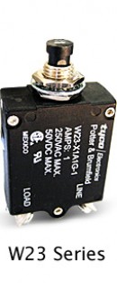

docc Posted October 25, 2018 Author Report Share Posted October 25, 2018 Plexiform "Just curious what the verdict is on charging the odyssey battery while it is still in the bike? Can I charge it while it is in the bike? Do I need to remove the 30amp fuse? My battery has been holding up well without any charging since I installed it but now that the bike has been sitting for a couple weeks the charge is down to 12.65 so I figure I should give it a full charge now. Thanks for the help." It should be safe, with the key off the ECU is not powered up and the regulator will be isolated by the internal diodes and SCRs As long as no magic smoke escapes go for it. I would be nervous pulling that fuse in and out since the holders are already known to be weak. Easy for me with the switchable circuit breaker installed. Yet, aren't those the same diodes that can "go bad" in the SCR regulators? 1 Link to comment Share on other sites More sharing options...

plexiform Posted October 26, 2018 Report Share Posted October 26, 2018 Plexiform "Just curious what the verdict is on charging the odyssey battery while it is still in the bike? Can I charge it while it is in the bike? Do I need to remove the 30amp fuse? My battery has been holding up well without any charging since I installed it but now that the bike has been sitting for a couple weeks the charge is down to 12.65 so I figure I should give it a full charge now. Thanks for the help." It should be safe, with the key off the ECU is not powered up and the regulator will be isolated by the internal diodes and SCRs As long as no magic smoke escapes go for it. I would be nervous pulling that fuse in and out since the holders are already known to be weak. Easy for me with the switchable circuit breaker installed. Yet, aren't those the same diodes that can "go bad" in the SCR regulators? I like the idea of a switch to connect and disconnect. Would love to see a picture of the circuit breaker you’ve installed. Link to comment Share on other sites More sharing options...
docc Posted October 26, 2018 Author Report Share Posted October 26, 2018 On 10/26/2018 at 8:15 AM, plexiform said: On 10/25/2018 at 10:27 AM, docc said: I would be nervous pulling that fuse in and out since the holders are already known to be weak. Easy for me with the switchable circuit breaker installed. Yet, aren't those the same diodes that can "go bad" in the SCR regulators? I like the idea of a switch to connect and disconnect. Would love to see a picture of the circuit breaker you’ve installed. Check out pages 4 and 5 in this thread showing how I installed this style of circuit breaker: 2 Link to comment Share on other sites More sharing options...
