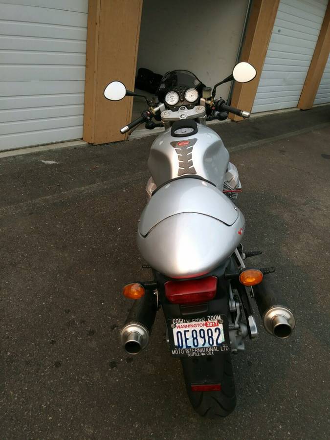

Here are all pics I have. Asking $3,400.8BB42405-E5AB-47FA-A2B5-D14A06BB6580.jpeg
Yes I see the 00 didnt have the black motor. I was told all stock except foe cans and fairing. If I wanted to avoid character I for sure wouldn’t have BMWs and be looking at MGs

For $3,400, I think you could find one that is all original if you are patient. That motor looks like it might have the 2002 fuzzy/crinkle paint. And it's not just the motor, it's the transmission too. If you really like that one, be sure you are satisfied with the explanation about the motor and tranny before buying it - cuz you'll have to convincingly tell that story again if you ever want to sell it.

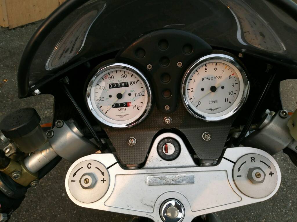

Instruments
So... the original dash for that bike would have been a brushed aluminum with silver light cover. It also would have been mounted with two screws, not three. That means somebody has replaced not just the dash panel, but all the mounting brackets behind it. Why? Could be personal preference... or could be to repair damage.
