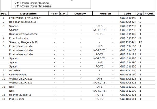

Lucky Phil Posted January 14, 2022 Author Posted January 14, 2022 8 minutes ago, docc said: "Allettante?" I can't really make any sense of the T5/T6. Where did you find this? In a published factory Parts Catalog? I ask because the Harper's breakdown is propriety to them and not factory literature. Here docc. This was the link which doesn't work anymore. For V11 Corse-Le mans 03-04. http://sparts.aprilia.it/stampatav.asp?w=&ntav=Front wheel&tav=34&ye=-&cou=-&ve...
docc Posted January 15, 2022 Posted January 15, 2022 Hmmm, I wonder if there is a "legend" in the beginning of that document that might shed some light . . .
Lucky Phil Posted January 15, 2022 Author Posted January 15, 2022 5 minutes ago, docc said: Hmmm, I wonder if there is a "legend" in the beginning of that document that might shed some light . . . No looked previously docc, nothing. Thats why I assumes Tenni but no other Tenni stuff in there. Btw Tenni's also had gold fork caps as well. Ciao 1
Lucky Phil Posted February 1, 2022 Author Posted February 1, 2022 On 1/15/2022 at 11:13 AM, docc said: Hmmm, I wonder if there is a "legend" in the beginning of that document that might shed some light . . . Pauldaytona supplied the answer to this. The RC, Rosso Corse has 2 types of Ohlins forks fitted a larger and small dia axle type, so T5/6 refers to that plus some other small changes. If you want details about stuff like this Paul is the man to ask. Ciao 1 1
Paul Minnaert Posted February 1, 2022 Posted February 1, 2022 The red frame v11 sport (KR) got some bad reviews in Germany and other places, because not as other old Guzzis, it wasn't so stable. They were delivered with 170 wide tire on 4,5", what is a to wide tire for the rim. And that makes the tire shape to pointy. German tuner Dynotec made a corrected version of the first gen V11 sport, other offset triple clamps were part of it. But in Italy, Aprilia just owned Moto Guzzi, and didn't want the bad publicity so they took drastic measures. The second generation(KS) got a wide tire rear, the popular 180/55 on a 5,5"rim. The area between swingarm and gearbox got a extra steel rods to make it stiffer. with extension to the engine crank case. The front engine mount was reinforced. And the steeringhead was extended to have more wheelbase. The third generation(KT) kept same geometry but got optical tweaks and the 43mm forks where this subject is about. Not all changes occurred at the same time, first mount old stock before making new. It has been always the same. The Dynotec v11 http://www.dynotec.de/presse/DynotecV11_2000MO.html 3 3
paulnaz Posted February 1, 2022 Posted February 1, 2022 On 1/14/2022 at 5:13 PM, docc said: Hmmm, I wonder if there is a "legend" in the beginning of that document that might shed some light . . . In the Guzzi Fiches I have found that revisions or specs are given in the last part of the breakdowns. In reference to T5/T6 it shows Up to Frame KT211300 =T5, After frame KT211301 = T6. Paul B 1 1
