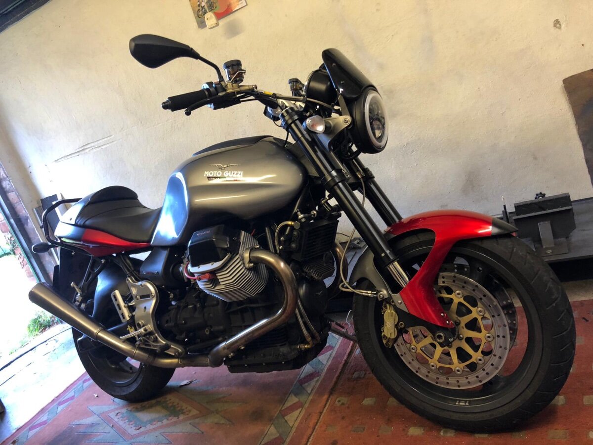

Steve S Posted May 5 Share Posted May 5 Wish I could have kept it , now have a Le Mans without the fairing and a high bar conversion in my old age, I’ve owned and restored 15 V11s in the last 12 years, probably most of them in the UK 2 1 Link to comment Share on other sites More sharing options...

docc Posted May 5 Author Share Posted May 5 On 5/5/2023 at 10:13 AM, Steve S said: Wish I could have kept it , now have a Le Mans without the fairing and a high bar conversion in my old age, I’ve owned and restored 15 V11s in the last 12 years, probably most of them in the UK Too cool, @Steve S ! I have long wondered how many V11 have benefited from your stewardship. Regarding the OE front brake pads, Tim at CadreCycle in Cincinnati, Ohio/USA, tells me he has three sets of these GU01654630 at $73.00US. Each V11 uses two sets. This morning OPP Racing sent me a tracking number for the order I made last night. Another member here tells me he has used OPP extensively for Brembo components and parts. 1 1 Link to comment Share on other sites More sharing options...
