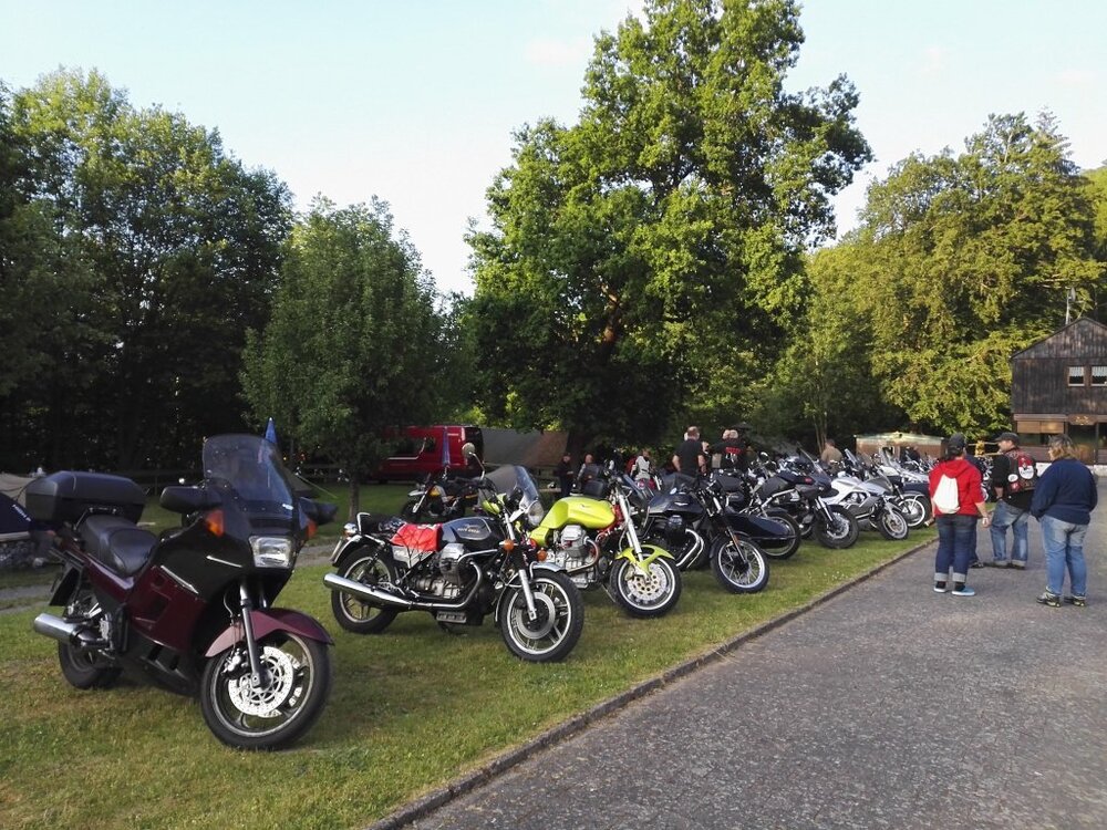

That is where I was last weekend, on the shores of the Eder Reservoir (Edersee) for the annual rally of the german language forum that I am active in. Cold at night in the tent, but lovely sunny weather during the day. Here are a couple of pictures:
( the GTR 100 on the left is mine. I went to a Guzzi Rally on a Kawasaki, but don't tell anyone... :whistle:)

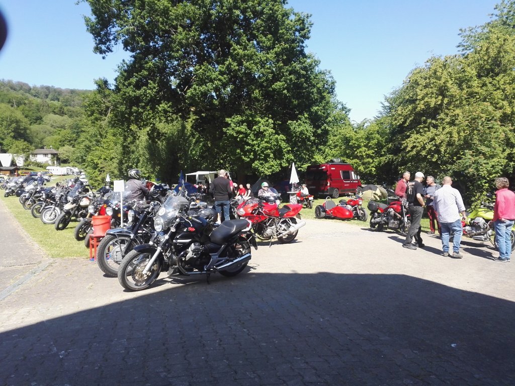

There were two spine frames there, the greenie on the right in the second photo, and a rather pretty 2002 Le Mans in red. The greenie had only fairly recently been bought by its current owner, and had a couple of issues, so it got looked at by the experts (and fixed...).
The friendly looking bloke in the red t-shirt is Bernd, the author of the Guzzidiag programme.
(If anyone should wonder why he is staring into a cardboard box, his laptop is in there. The box is so that he can read the screen in the bright sunlight.)
PS: sorry it is such a shitty photo. Shot from the hip with a telefon in full sunlight, so I couldn't really see how the photo was going to turn out. I'll try harder next time... B)

Any more closeup pics of the Guzzi with the sidecar there in the background?

No, I'm afraid not. It is a Le Mans 850, if I remember correctly. I didn't look at it very closely, but it looked very trick.
There was also a Daytona sidecar there. I think it is a shame to bolt a side car on a Daytona, but it was very well done. The owner bought it that way, and he loves it. I think there were about half a dozen side cars there in total.

It was basically just a "decent tune up". Karsten (yellow t-shirt and overalls) did all the tinkering, Bernd checked what Guzzidiag can check.
They set the TPS (goal was 160 mV, it ended up at about 158), balanced the throttle bodies, set the CO trim. For the CO, they started at -20 and varied back and forwards in steps of 10 to see how it reacted. The focus was on just off closed throttle, i.e. how snappy it was when the throttle was opened from idle. The final setting was -20.
